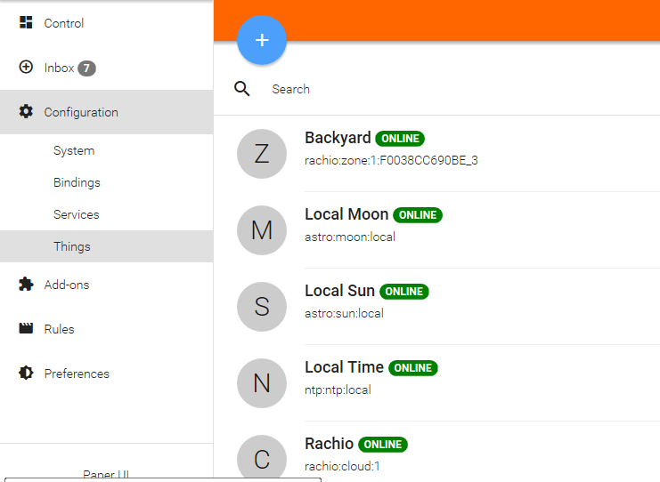

I start making progress, binding is able to connect to rachio cloud auto-discovver controller and zon
several exceptions and I need to refactor, but a first step is made.

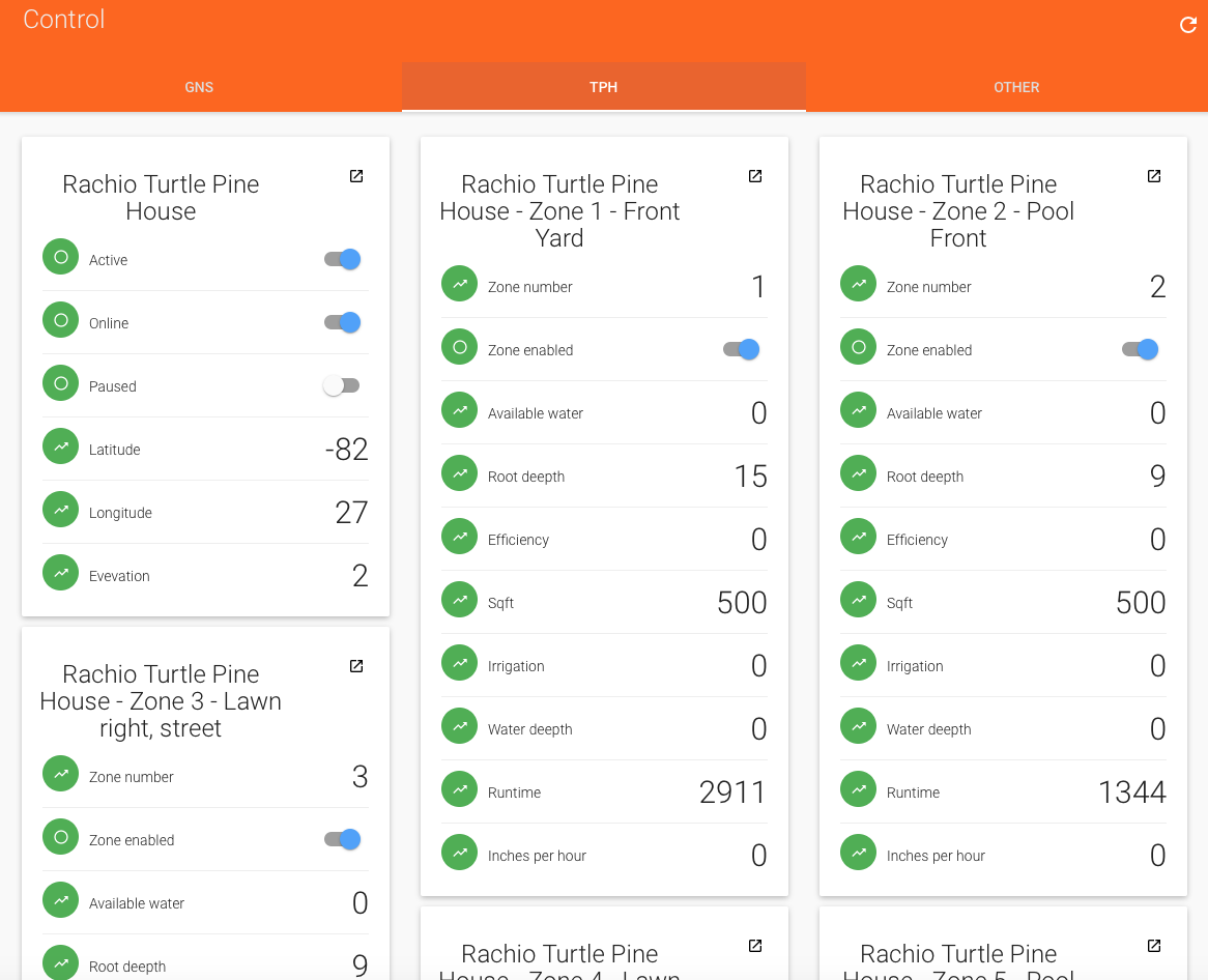

making progress

which could result in a ton of channels. I already selected a bunch (see screenshot).
What do you think makes sense to have for
a) Just visualizing the status and progress + some basic control
b) getting enhanced information to implement your own schedules etc.
@ashley_stovall, @ranielsen, @NCO, @Agbush, @KidSquid
