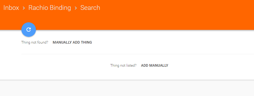

go to the inbox and run a scan on Rachio
Scan returns no results…

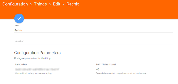

Thing file was created and is visible in PaperUI
The .jar file was loaded as it’s provided logging information in it’s dedicated log file.

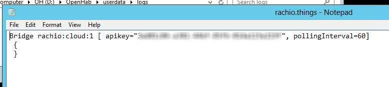

please create a .things file:
Bridge rachio:cloud:1 [ apikey=“xxxxxxxx-xxxx-xxxx-xxxx-xxxxxxxxxxxx”, pollingInterval=60]
I did, that’s what created the THING in PAPER UI.

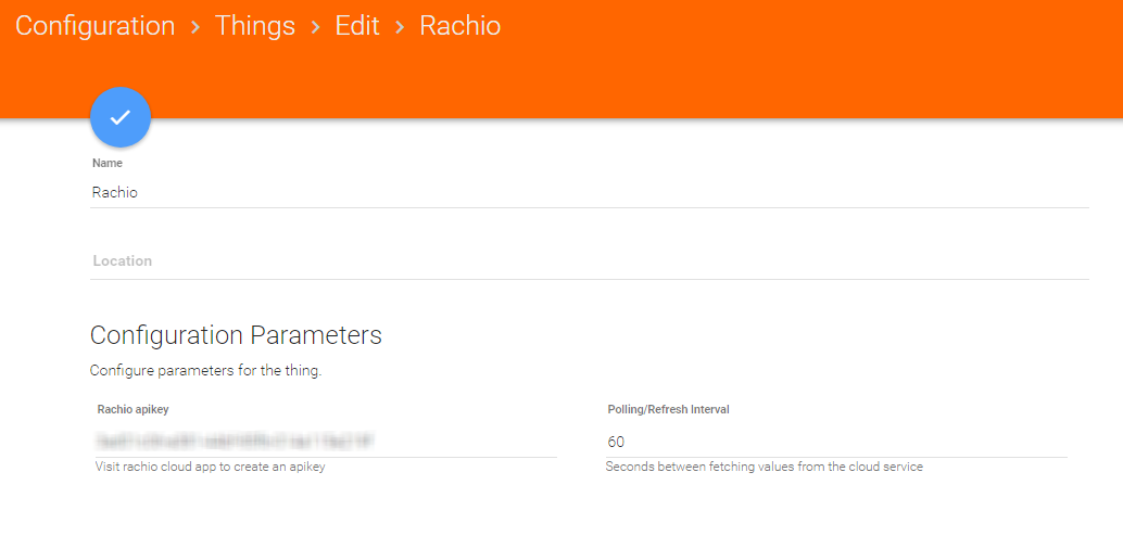

do you see the bridge thing under configure->things?
The bundle is loaded, I see the auto-discovery (which is not yet implemented), but I don‘t see the manual scan
Yes, look at the post a couple of items up and you’ll see my screen grab from Configure → Things

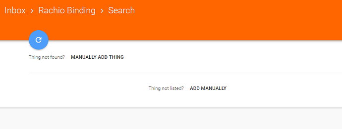

Again if you look up a couple of posts you will see the results of my manual scan where it did not return any results.
