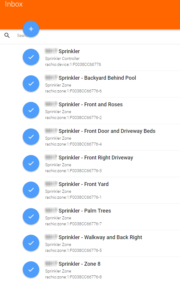

ok. received the file…should I delete the .THINGS file I created yesterday before adding this new version of the binding?
no, let it as is
add 1 controller and 1 zine to check if properties are displayed correctly. send me the log
Sent you the log file via email.

Also seeing this in the OpenHab log file:
2018-02-08 15:54:32.345 [WARN ] [ore.internal.thing.ThingTypeResource] - Cannot find channel type: rachio:zone_head
2018-02-08 15:55:31.675 [WARN ] [re.thing.internal.ThingFactoryHelper] - Could not create channel 'noizzle_head' for thing type 'rachio:zone:1:F0038CC66776-1', because channel type 'rachio:zone_head' could not be found.
