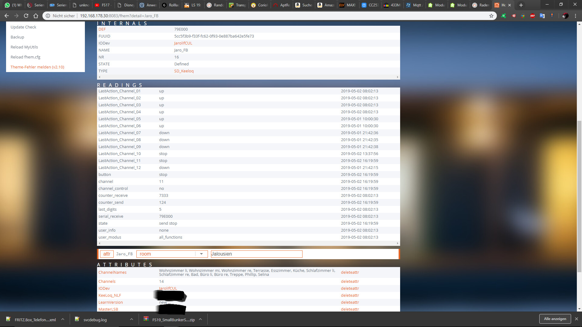

Hello, that sounds like a great way to control FHEM by OH. Unfortunately, I’m not quite here because I use Jarolift engines and there is also a module in FHEM. The bridge is on, it seems to have worked but it stops here. Maybe you could help me with an example of my situation as I put on a bridge for the first roller blind. @christoph_wempe
This is what i have for now.
This is what happens in the log, so i dont know how to name my mqtt device bridges.
2019.05.01 09:53:31 3: JarolifCUL: Jaro_FB set stop 1
2019.05.01 09:56:27 3: JarolifCUL: Jaro_FB set stop 5
So 1 and 5 are Wohnzimer links and Esszimmer. So the device name is 1, 2 ,3 ,4 ,5 and so on ?
