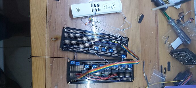

I have 5 rollofron confort Duofern that I wanted to integrate with Homeseer.
The software solution is very complex for me and therefore I preferred a hardware approach.
I bought a Duofern Standard Manual Transmitter (6 channels / groups) and hacked it
I basically connected the transmitter keyboard lines to the relay outputs of an arduino that is controlled by Homesser. So now I’m able to control the rollotron units locally, by PC, by mobile phone and by echo dot, using IFTTT
It is a laborious solution but I have not found a simpler one and it is working very well … :grinning:
Respect, @Antonio_Jose, I often searched how to integrate Duofern, but never came across the idea to hack the remote control. Really nice idea.
