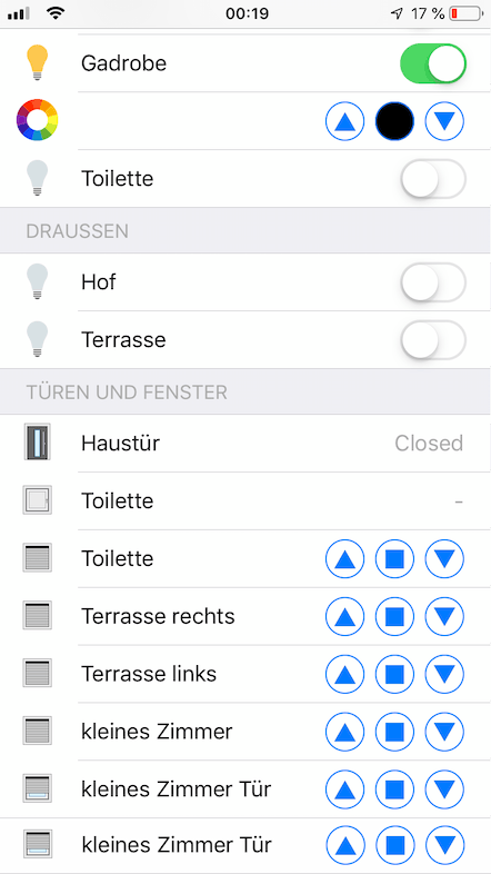

At the end, it looks and behaves like a native roller shutter, including blind position visible via the icon:
openhab
