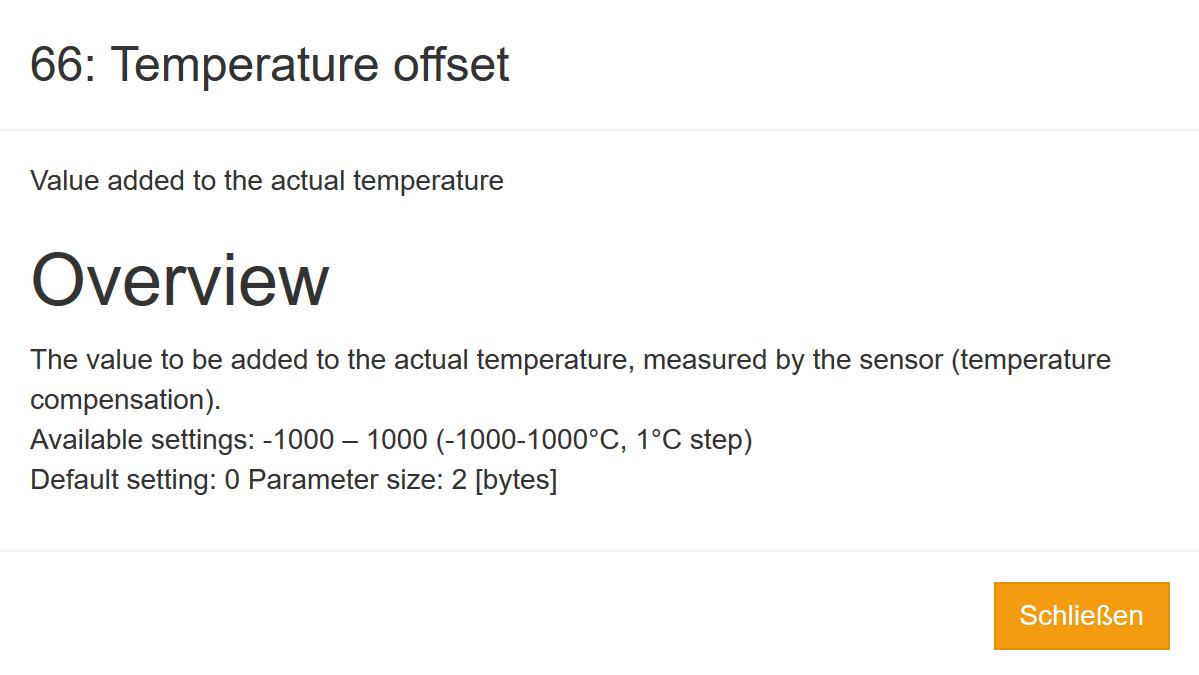

I’ve got a Fibaro Motion Sensor FGMS-001 and use the integated temprature-sensor to regulate my themostats. In the preferences it is not possible to adjust the measured celsius temperatur in floating point values for celsius units.

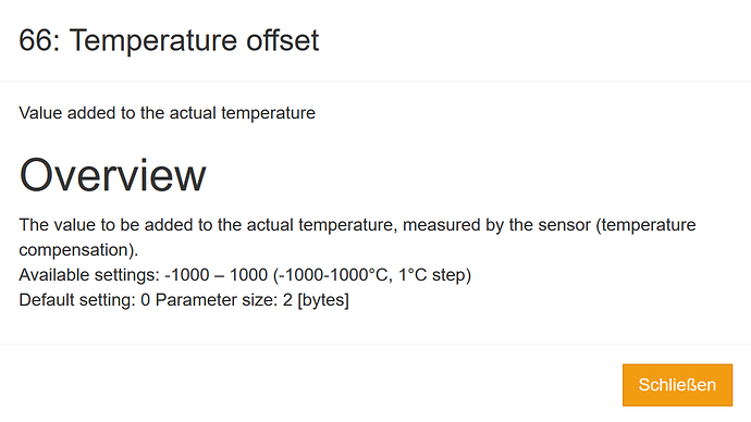

Parameter 66 allows to set an offset: grafik
The offset could only manipulate with the minimum of 1°C.
Is there any option to raise the minimum from 1°C ?

The database (I think) is correctly reflecting the manufacturers manual -:
Therefore there is nothing the binding can do as the device is calibrating this in 1 deg C steps (as per the manufacturers manual above).

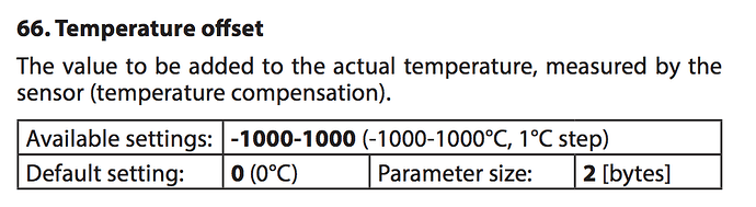

Did you test what changing the offset really results in ? While in line with the manual, I think that one is buggy
(-1000°C ? interesting concept…).
For my (older firmware) FGMS the docs read -100 to +100 which makes more sense.
Yes I tested this after your reply. It seem that the manual is buggy. The offset of -15 makes an offset of -1,5°C

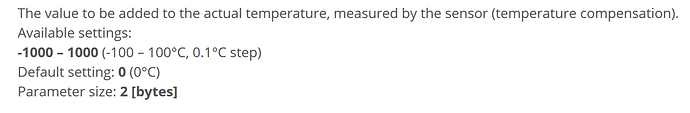

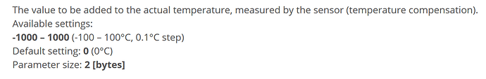

The Fibaro manual for firmware 3.2. has 0.1°C steps grafik
I cannot find a manual for my firmware version 3.3 on the fibaro website. @chris what is your source for the screenshot ?
It’s the Fibaro manual that is currently in the database, and on which the database definition has therefore been created.
If it’s wrong, then please feel free to update it.

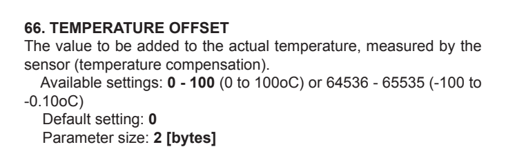

Firstly, I don’t think this is the version of the device you have. This device shows the temperature is only allowed to be 0-100 in the manual and it’s not therefore the same as you mentioned earlier.
I think you have this version.

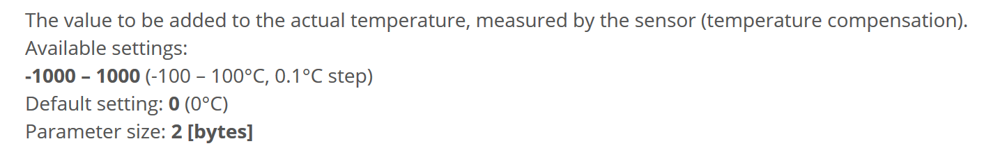

You are absolutely right. I was in the wrong version. Fibaro has published a new version of the manual see https://manuals.fibaro.com/content/manuals/en/FGMS-001/FGMS-001-EN-T-v2.1.pdf
