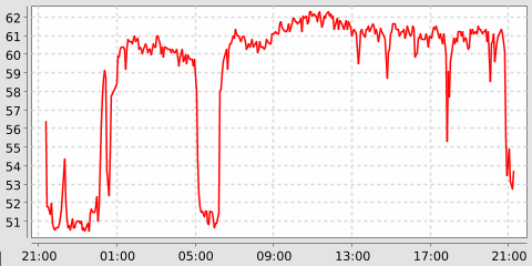

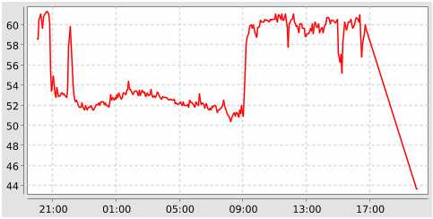

on my new RPi3 I have quite higher CPU temperature as on my RPi2.
I‘m currently between 60 and 65°C which seems quite high formy opinion. My old system was between 35 and 50C depending on the workload. My PRi3 seems to idle on a very high level.
Is this only me - or is this a common issue?

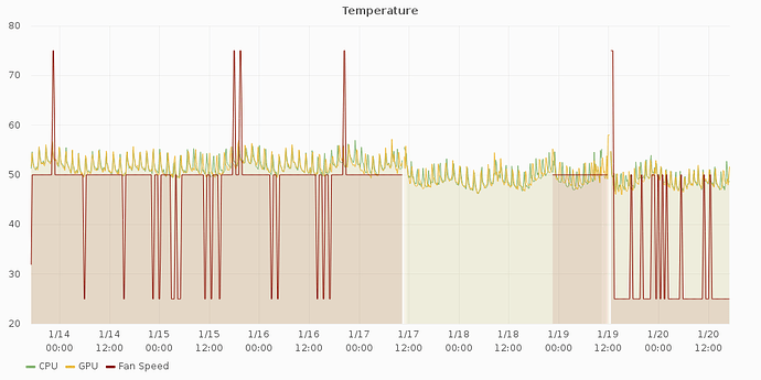

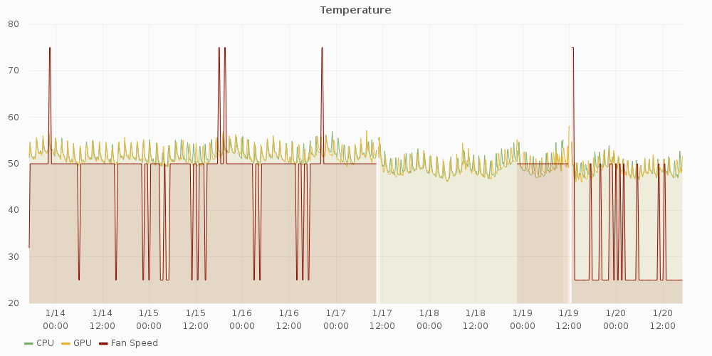

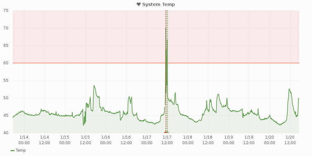

Not sure if this helps or not but below is the temp on my PI3 over the past 7 days, Im only running OH 2.2 on this pi with grafana and influxdb running on a separate PI3.
The Pi has a UPS hat on it with a variable speed fan, the break in the fan data was me tweaking settings and breaking things but the CPU/GPU values were consistent, the fan is controlled by a rule set so switch 25%, 50%, 75% or 100% depending on temp, the Pi lives in a cupboard near main fuse board and wireless router/Network patch panel and there is little natural air flow.

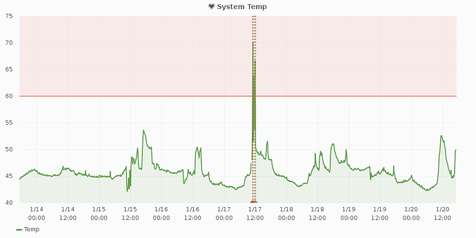

Added Grafan/Influxdb server temp, CPU only, for comparison, this currently sits on a window sill in my study but will eventually end up co-located with the OH server when I get time to be bothered to move it.
No UPS or fan on this just plain old heat sinks on the usual components.
Mainly providing for comparison.

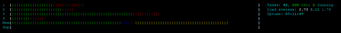

Also interesting - seems like the openhabcloud binding is a real resource killer: When I install the binding, my temp. is between 63 and 67°C; without that binding it’s 58-59°C.
But even without, I have a significant cpu utilization:
Is this normal???

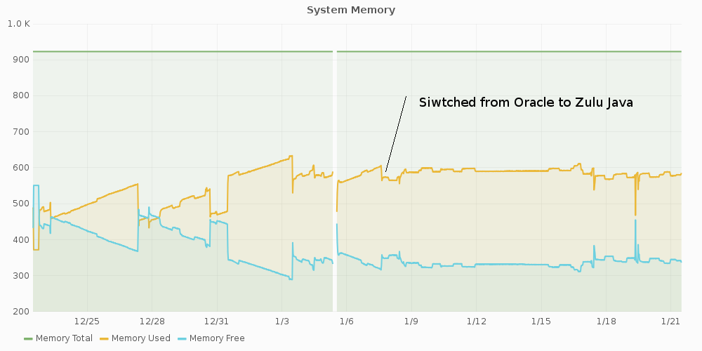

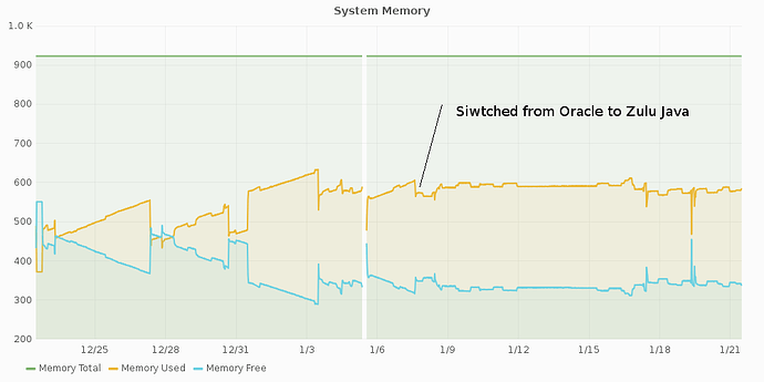

On a slightly separate and more positive note I did recently move from Oracle Java to Zulu “1.8.0_152-b76” and memory wise things have improved and I’m not seeing such a consistent upwards trend.
Should have said this change includes the fact I’m running the same bindings before and after.

But the result is the same - too high for my opinion. What I do also find strange is the behavior in the last 24 hours:

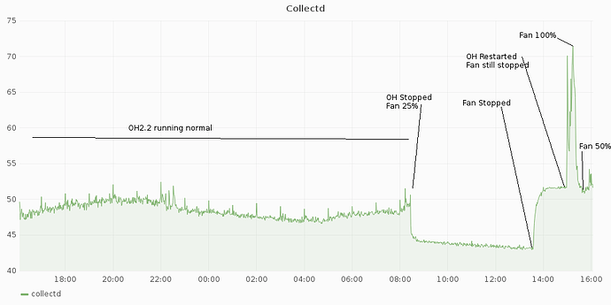

Hi Boby,
Ok below is my basic findings for the past 24hrs using system temperature as provided by collectd.
  1. Stats start 4pm yesterday, roughly, with variable fan running at 25% for the majority of time.
  2. Shutdown OH at 08:30, I left fan running at 25%
  3. 13:30 I decided to stop fan entirely.
  4. 15:00 restarted OH - fan still stopped
  5. 15:15 Fan kicked in a 100%
  6. 15:40 Fan reduced to 50% and still running as such
The PI remained in the same place throughout the test with no one opening the cupboard door allowing additional air flow.
My conclusion is that Ive now switched from the exec binding temp to the sysinfo temp as it’s closer to the truth and hopefully provides better data, that with no fan running the PI levels out at about 52 C and with OH2.2 running it hit 70 C before the fan kicked in on 100% and brought things back under control.
