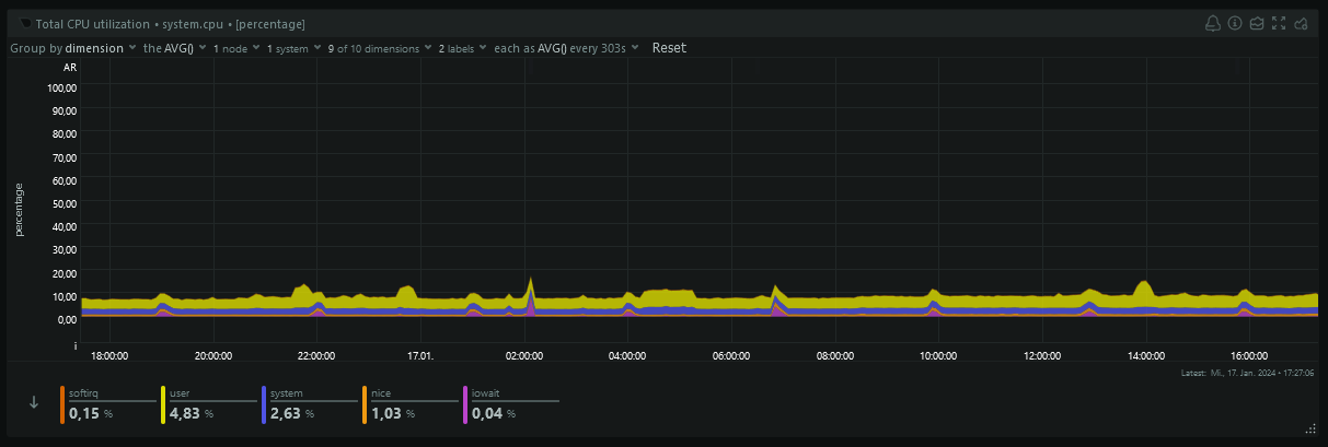

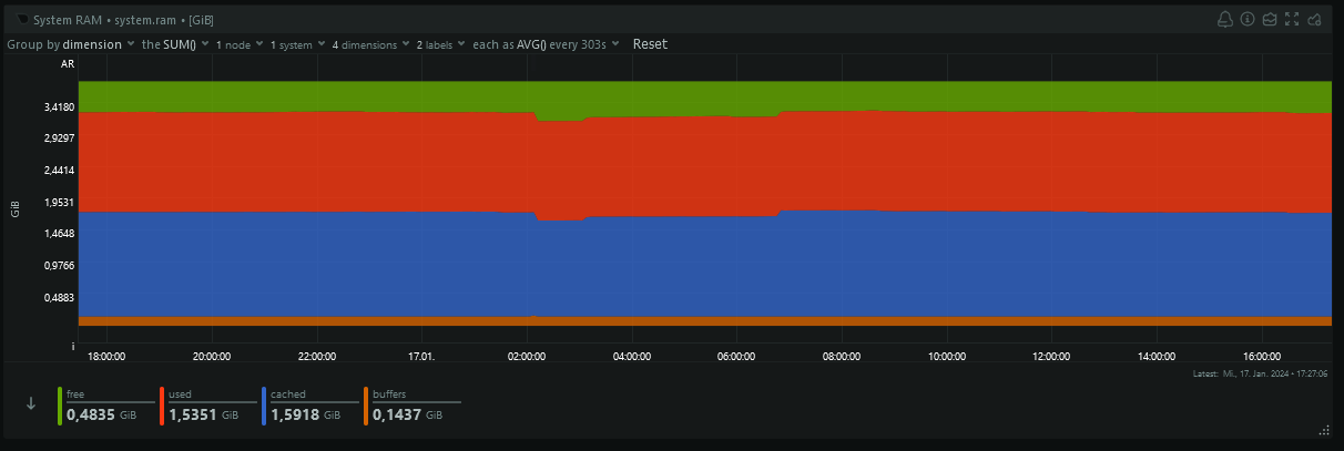

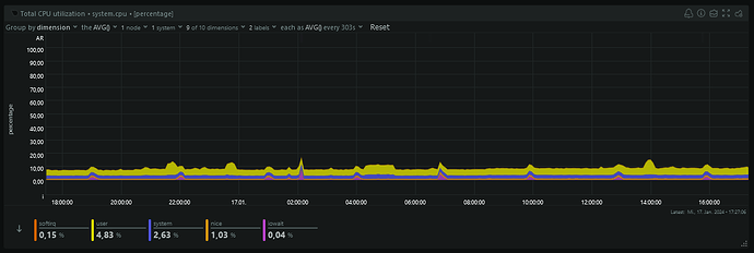

But for real, the benchmark isn’t number of items or rules - but what kind of load they generate. you can have 100 light-switches or 100 PV/inverter items. The lights will only change status once in a while, whereas inverter items tend to change every second.
Meaning: if your system is dependend on “real-time” events, it’ll generate more load than if you have more or less static states.
My setup is currently at 1200items, 93 rules (some four-liners, some >200lines), my events.log gets rotated daily and still my Pi4 idles at 90%. Currently it’s running only OH-stuff, but also an netdata-instance, a zabbix-agent and promtail sends every log-entry to a grafana-service also - and some more small services.

And that’s not even near one of the bigger OH-installations! There’s loads of more complex instances running somewhere!
for the interested:
