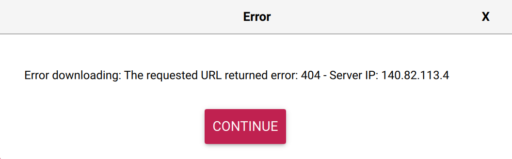

Hey guys,
I’m following the installation instructions for openHABian on an 8 gig RPI 4. I am encountering an error with the Raspberry Pi Imager when I select Other specific purpose OS then Home assistants and home automation then the 32 or 64 bit version of openHABian. Any ideas?

It looks like the image was just updated a few hours ago, so I suspect that the links haven’t been updated yet in the Raspberry Pi Imager. In the meantime, you can just download it and then use the imager to install the local file.

The naming-method of the filenames in the repository had been changed.
That’s why the imager is currently not working.

Nope, I stumbled over this issue by myself and as the Pi Imager states 2024-02-04
So this is no issue with Pi Imager, but the links inside the rpi-imager-openhab.json file, which is the source for the Pi Imager.
See
https://github.com/openhab/openhabian/issues/1837
