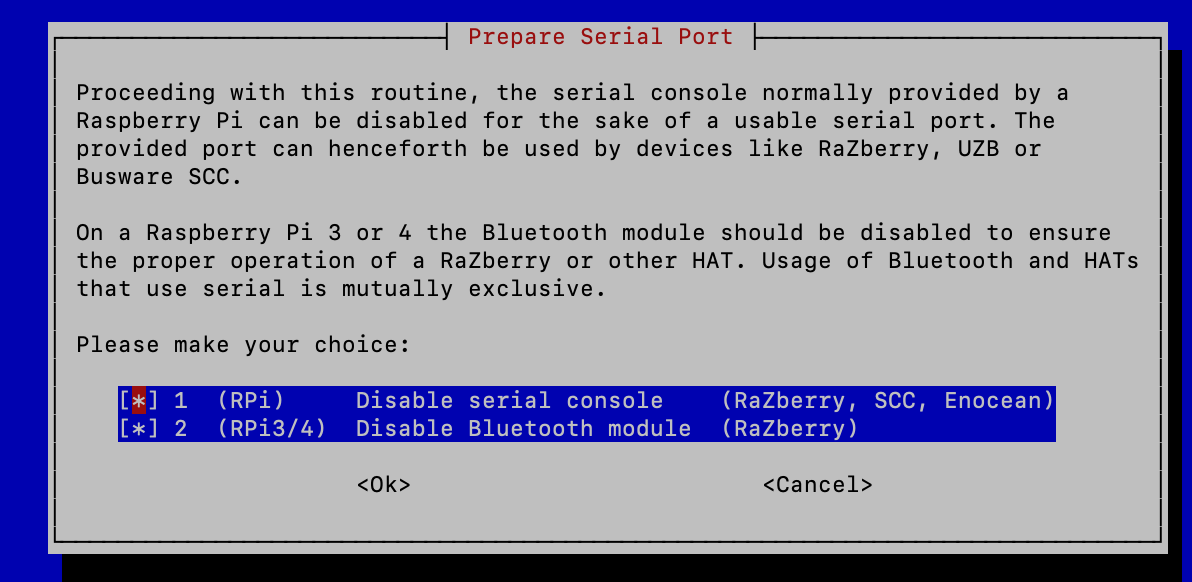

For anyone who is interested, I wanted to use both the Razberry and the bluetooth module for the mi flora plant sensors on my Rpi 4 and this is in fact possible.
Enable Use of Razberry and Bluetooth module on Raspberry Pi 4 at the same time
Youre doing everything at your own risk, make a full sd backup before applying these changes!
First thing to do is to ‘disable’ the serial port and the bluetooth module in the openhab configuration tool:
sudo openhabian-config
Navigate to
  1. 30 System Settings
  2. 35 Serial Ports
    Select both entries with SPACE bar, should look as follows:
Select Ok and let the configuration tool do its thing (I think even a restart is required).
