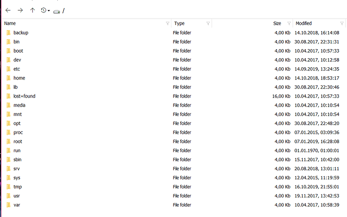

my system was running with a Raspb. 3 and openhabian (2.3.0.1) without any big problems since 2017.
Today some lamps in the garden didnt turn on and i thought i reboot my raspberry. (sudo reboot)
All was looking normally via ssh before reboot. And now “Host is down”. (aaaahhhhhhhhhh)
Via HDMI i get KERNEL PANIC now !?
What is happening ? Can someone help me to get my system back ?
i can see all my data with “linux reader” (boot and files) on windows and already created an image of my files.
i have done nothing the last few months with my raspberry/openhab, only today to reboot.
