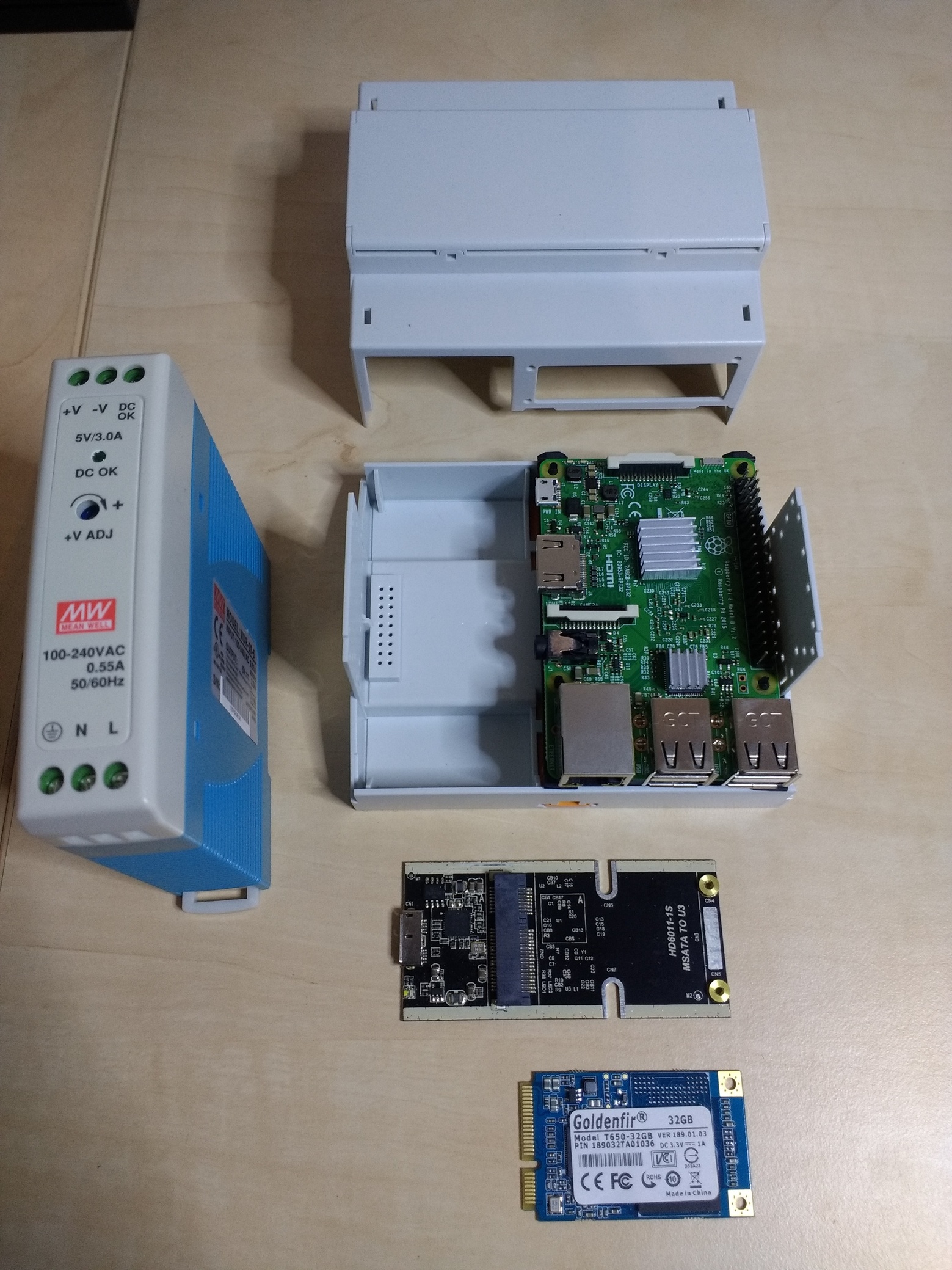

I saw there are some really cheap SSDs available for the Raspi so i got one for my OH2 server and an USB interface for an old SSD i had laying around so now the homematic piVCCU server runs off SSD as well. Here’s my shopping list, in case you plan to move off sd-card too, it’s highly recommended:

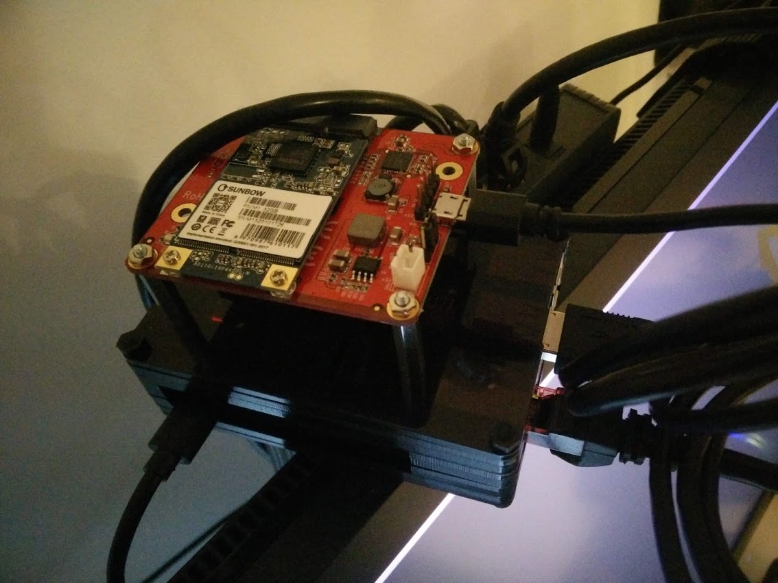

It’s a good idea to move of ssd. I also added an ssd after having 2 corrupt sdcards. I just bought a very cheap ssd and adapter to check if that works. So far it’s been running for several months:
Here is my list:
SSD:
https://www.aliexpress.com/item/Mini-PCIE-mSATA-SSD-SATA3-iii-SATA-ii-8GB-16GB-32GB-64GB-60GB-128GB-256GB-HD/32711811258.html
SSD-Adapter:
https://www.aliexpress.com/item/Super-Speed-Mini-USB-mSATA-SSD-to-USB-3-0-Converter-SSD-Adapter-Card-High-Quality/32820898209.html
And a short usb cable to connect the adapter with the raspberry pi.

How does the SSD hold in the case?
What is the case that you are using for the PI?
Is the SSD also in the case? It looks like if you attach the SSD then you can’t use the complete case anymore? Will that cause problems with dust and dirt?
Is it your first TCSUNBOW ssd?

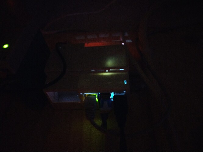

the SSD is tucked away in the cover. The middle part of the case cover is a little higher where the ssd fits. On the image you can see a white light shine through the cover. That’s from the SSD.
