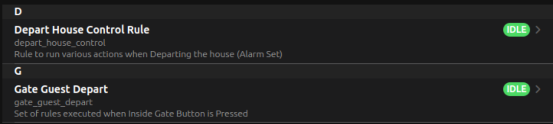

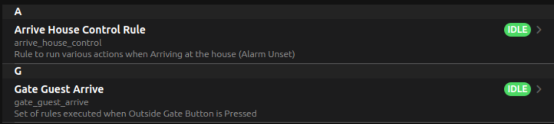

  1. Create rules aligned to Scenarios
    Some examples below of what I mean by Scenario-aligned
So these examples are for when guests arrive/depart at the gate, or we arrive/depart the house.
