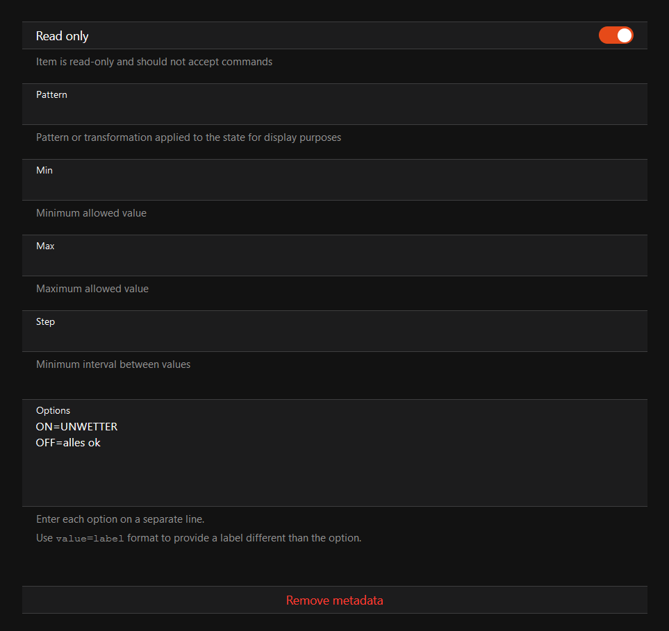

I am connected to a service which tells me if there is a weather warning for the region (“DWD Unwetter Warnungen”). The corresponding channel is represented as a switch and I linked it to an Item. The issue now is that I added that status info to the sitemap and I can switch the status manually, which should not be the case - the switch should be read only. I already saw the option to set “Readonly” in the metadata settings for the item but that does not work unfortunately.
My workaround now is that I added mapping info inside the metadata and set up the status as a text element inside the sitemap.
grafik
That workaround works for me now… but isn’t there a proper “Read Only” Setting for switches which I overlooked?
Or did I realize already the “best practice” for this issue?
If you have a read only Item of any type, use a Text element to display it on your sitemap.
Ok, but then this means that it will not be visualized as a switch symbol anymore but just as a text with ON / OFF -or as in my case- with the mapped values. Is that right?
Correct, but in sitemaps the toggle will always be interactive. There isn’t such a thing as a read only Switch element on the sitemap.
