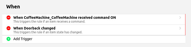

Does the screenshot below cause a triggering item?
If it doesn’t create a triggering item then that could be the issue?

One additional note. event is only populated when the rule is triggered by an Item. Not when it is manually triggered nor when it is triggered by a time event.
But, when you do have the rule triggered by an Item event, event will automatically be declared and populated for you. There is no need to declare it yourself. And in fact if you declare it and initialize it you run the risk of wiping out the stuff put into event when the rule is triggered by an Item event.

How is the rule triggered? If you trigger it manually or by a time based event there is no event. If it is triggered by an Item then event will be passed into the Script Action and it will hold a bunch of stuff about the event that caused the rule to trigger.

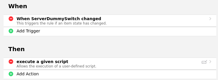

Here’s the rule I sometimes use for testing various things during my own script development. If I need to make sure that some particular event-driven code works, I add it to the end of this rule’s script.
This item:
when changed (in this example the item was switched `OFF’) triggers this rule:
which runs this script (note: newState is also an automatically declared variable in a rule triggered by a change of state event):
logger.info([itemRegistry.getItem(event.itemName).getLabel(), 'Changed From:', event.oldItemState ? event.oldItemState : 'Null', 'To:', newState].join(' '));
and results in this log output:
2021-02-05 08:09:56.512 [INFO ] [org.openhab.rule.0ef1478b17         ] - Testing Switch Changed From: ON To: OFF
