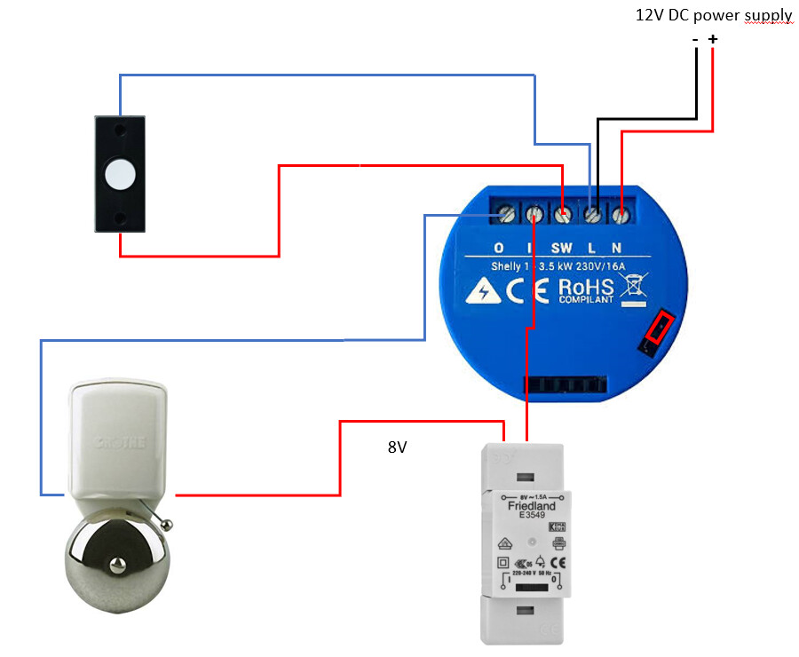

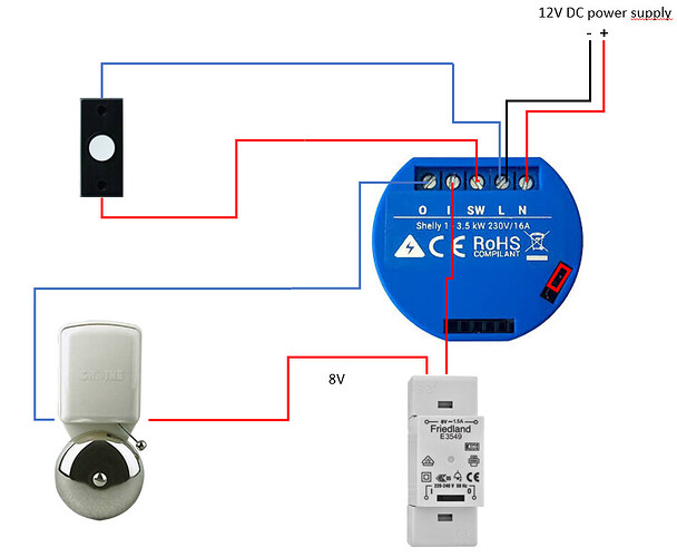

Thus far the solution with the Shelly runs stable for the last 5 months. Reasons why I made this: No cloud subscriptions, no external company’s to decide the solution is no longer supported and the sport to get it to work.
I used this wiring diagram as example. The Shelly is connected to a 12v DC adapter. The chime can run any voltage needed (not just the 8v shown in the picture).
