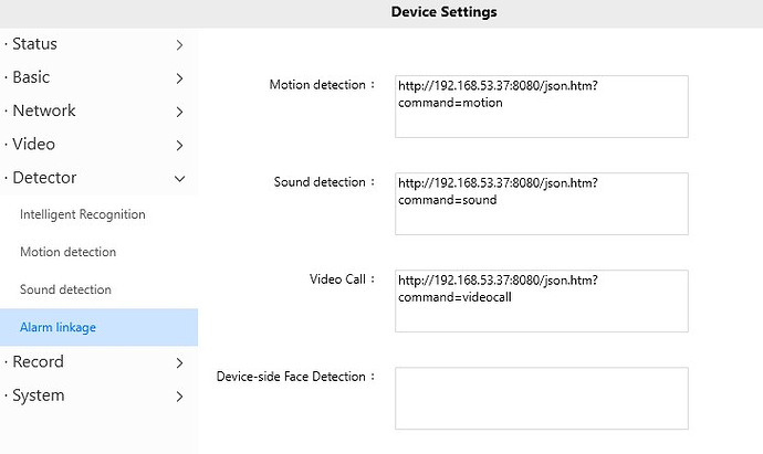

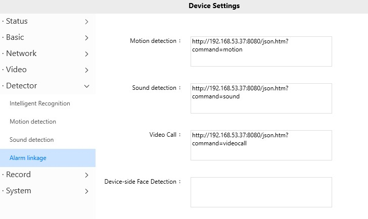

I have a Foscam VD1 which is ok.
Read the door chime button via HTTPLister binding and output an audio sound via Amazon Echo.
As far as I know you can also download video and images directly from the camera via FTP.
See also my entries in the forum about the Foscam
