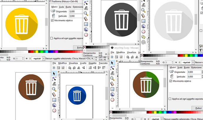

Then I crafted 8 svg images to match the day so that the TextRecycling item changes its icon dynamically:
You can then show the item in HabPanel with the icon/images you created.
I’m attaching a sample of my icons (sorry the text is in italian) but you can create your own.

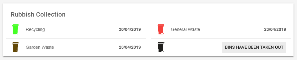

I have a simmilar problem, but we dont have fixed days every week.
Its more like
Week1, Wednsday general waste,
Week2, nothing
Week3, Thuesday recycling, wednesday paper
Week 4, nothing
week 5, like week1…
In addition there are sometimes movements +/- one day due to public holidays in a week.
So was thinking that maybe I need to create a special Google Calendar for this?
Or are there other ideas how to achieve this?
