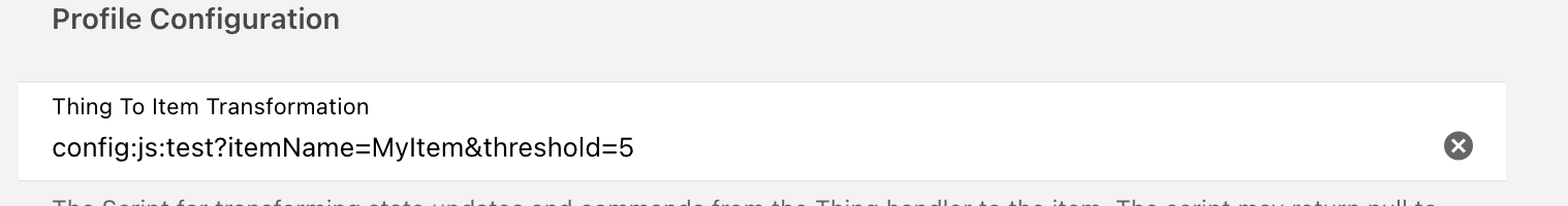

However, the Script transformation supports passing arguments to the transform (works for any languages including Rules DSL).
Let’s pass the itemName and the threshold as variables.
Passing variables works the same as passing values to a form in a URL: ?var1=value&var2=value2. So assuming the transform is in the file filter.js you’d use filter.js?itemName=MyItem&threshold=5. I think for Rules DSL it would be filter.dsl?itemName=MyItem&threshold=5. If you defined the transform in the UI just append ?itemName=MyItem&threshold=5 after selecting the transform.
The variables will be injected as a String, same as input.
Then the JS transform would become:

Right. Is there also a way in the “Thing to Item Transformation” to get the itemName automatically? At the moment I type it in manually.
config:js:delta_filter_abs?itemName=ActivePower&threshold=2
As I said above, no. The only way is to pass it in.
