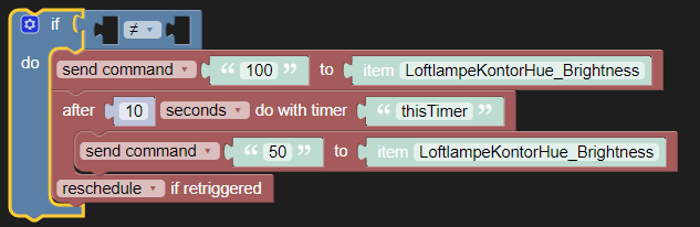

I’m building a rule that will be triggered by motion detection from several cameras. Depending on which camera detected the motion and triggered the rule, the Blockly script are to send a command to a specific item. So the goal is to avoid creating >10 Blockly scripts for each source/destination item and instead build one. When building it by hand I can refer to it using event.itemName but how can I refer to event using the Blockly UI?
For example:
logger.info('IPCamera brightness triggered: ' + event.itemName);
While in Blockly I can only refer to pre-selected item, like this:
Thank you!

I also had to move the following lines from above “if (typeof this.timers[‘thisTimer’] === ‘undefined’) {” to below it, as otherwise these would fire every time the script runs, even if an existing timer is running:
var OutdoorLamp_Brightness_preState = itemRegistry.getItem('OutdoorLamp_Brightness').getState();
events.sendCommand('OutdoorLamp_Brightness', '100');
as one would expect from the following blockly UI element, from which the above code is inspired by:
I know by now, this is starting to demand quite a bit from a GUI :grinning_face_with_smiling_eyes:
