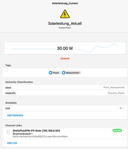

    I have an item of type: “Number:Power”.
    When using this item to feed some widgets, the number shown provides 2 digits decimal places precision.

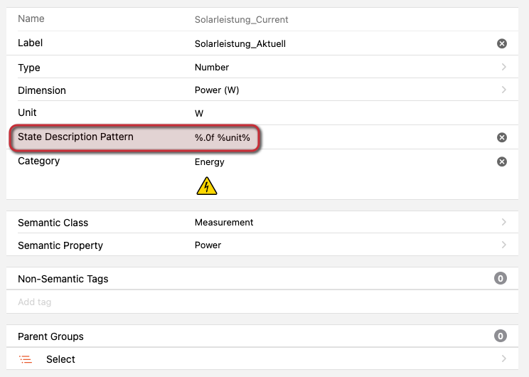

    I would like to redefine its representation and found the “State Description Pattern” in the GUI, see below.
    But the “State Description Pattern” does not seem to be editable. (and I would have expected zero decimal places)
    What is best practice to convert the e.g. “30.00 W” to integer type “30 W” or single decimal place “30.0 W”?

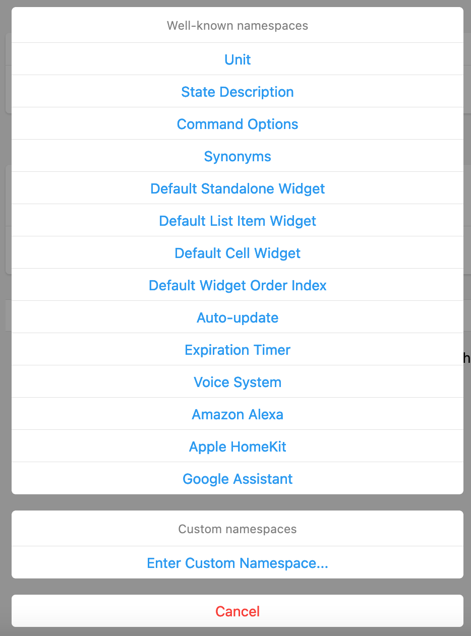

In the mean time, click “Add Metadata” and add the Item metadata there.
I’m running openHAB 4.2.0 with Build #3974. (It’s an openHABian installation.)
Which metadata provides capabilities to change decimal places?
State Description
%.0f %unit%
The build you have running should have the changes to the unit UI included.

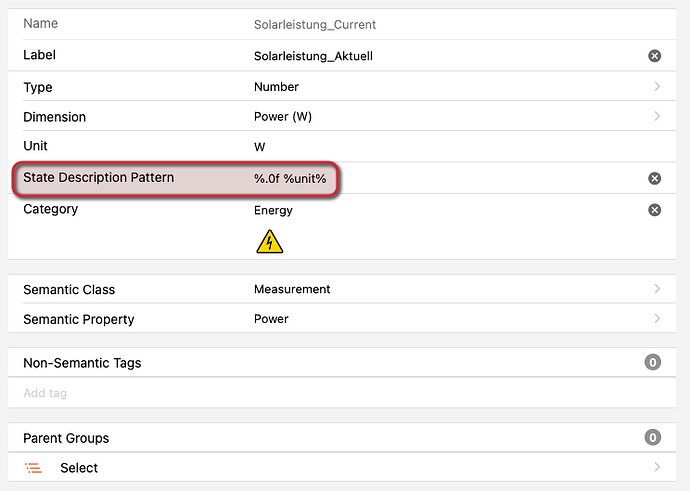

The UI shows the default state description pattern (%.0f %unit%) when none is set. When that is not changed, it is not saved.
Did you try changing it to e.g. %.1f %unit%? Could you remove the State Description metadata again and try setting it? Did the metadata State Description get created? If that works, the issue may be that the default state description is not used at all in Main UI.
I find it shows %.0f %unit% even when the State Description one is set.

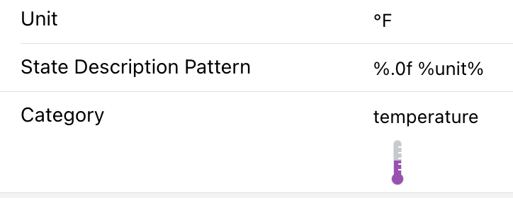

For example:

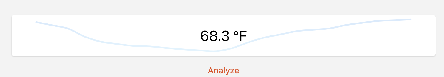

I have a temperature Item withe a State Description Pattern: %.1f °F
I can see it’s applied.
But the “State description pattern” on the Item’s edit page still reads %.0f %unit%.
