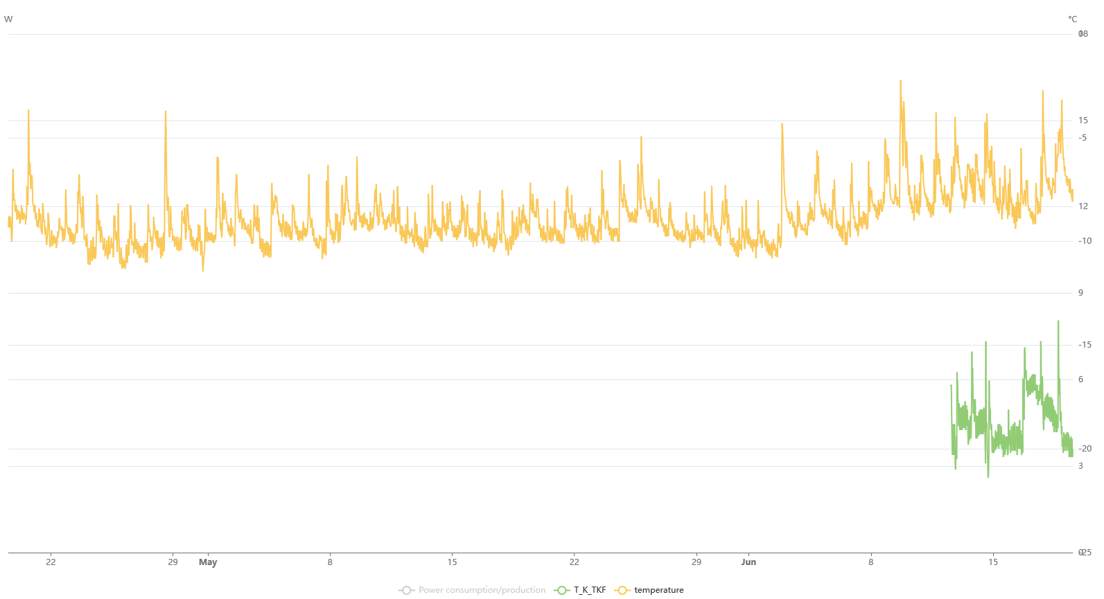

Zigbee temperature/humidity sensor (Sonoff SNZB-02 - yellow), TFA Dostmann temperature sensor (433 MHz via SDR - green). Battery of the Zigbee sensor still at 100% (after two months; according to sensor report):
