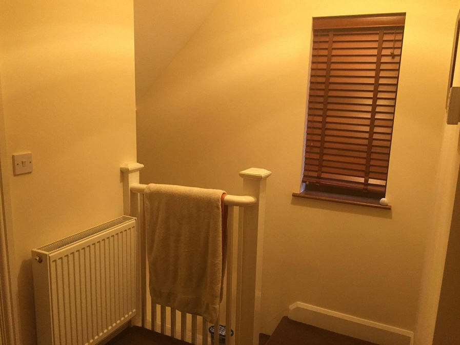

Ok, thanks for the feedback. How bright are Hue bulbs? From what I’ve read I’ve got the impression they’re not suitable to use as the main light in a room (normal sized)? You see, while I’m interested in controlling colour temperature I’m unsure about the real effectiveness of smart bulbs simply as lights.
I must say I’ve been disappointed by the lack of depth, detail and rigour I’ve seen in reviews of smart bulbs, et al, in the general marketplace…
This is a dark hallway lit with just one of the dimmable white HUE bulbs, displaying quite a warm colour. (That device on the window seal is my zwave motion sensor, it turns on the light whenever motion is detected and the room is dark enough)
