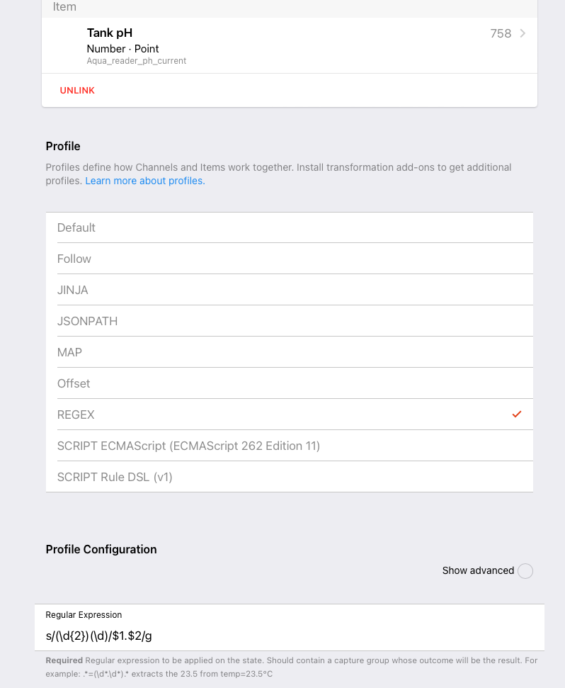

On of my tuYa measurement device exposes value as integer (e.g. temperature is not 23.4C by 234), pH value is 721 instead of 7.21
I tried to applied a regex transformation to the channel
s/(\d{2})(\d)/$1.$2/g
that one should take first two digits add a dot and than third digit (regex version of div / 10).
However it does nothing and the presented value remain the same “721”
When I change an item type to String instead of Number than I have “72.1.0” .. so regex works but an additional suffix is added “.0”.
Am I doing something wrong, or is it a bug in the regex transformation plugin?
Screenshot 2023-10-27 at 18.06.24
The REGEX transformation is primarily designed to extract a single value for a larger String or document. As such it has limitation and restrictions which make it non-standard.
  1. The expression must match the entire String or document, not just one line or part of a line. You’ll usually see expressions bracketed by .* to create that.
  2. The first matching group (i.e. set of parens) is what is extracted from the String or document and returned.
  3. If the expression doesn’t match the String or the first matching group is not found then the transform returns null and the update is effectively ignored.
I suspect 2 is getting in the way here.
You will probably have better luck using the Offset profile which you appear to have installed and was created expressly for doing these sorts of simple operations (see the Modbus docs for details).
Or use a SCRIPT transform to implement the division in code.
Thanks a lot! It’s exactly as you explain if regex matches the whole string it works perfectly fine.
s/(\d{2})(\d).*/$1.$2/g
I had strange behaviour after adding a format “%.1f” to see the whole value
Could not transform state '757.0' with function 's/(\d{2})(\d).*/$1.$2/g' and format '%.1f'
I had to add it to state description as an item’s metadata to make it working. Thanks again!
