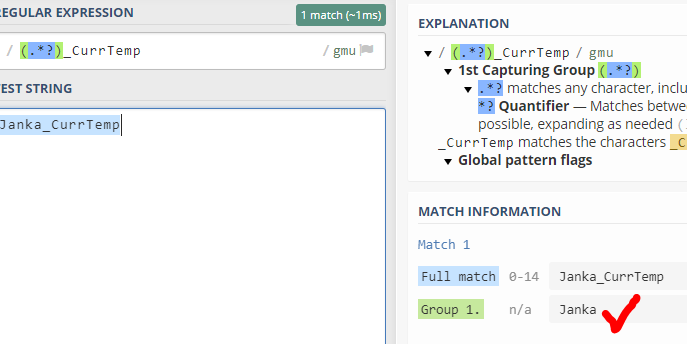

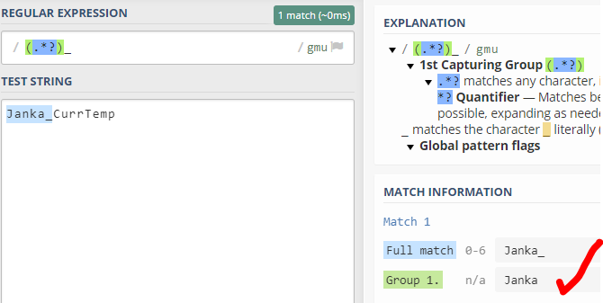

If I check it on Regex101 the result should be the same:
searching for “CurrTemp":
searching for "
” only:
Thanks for any hint
This regex is a full string comparison. (.*?)_ doesn’t result in any matches because your pattern ends in an underscore, but your string does not. If you add one more wildcard to the end of your pattern (.*?)_.*, it will be able to match all your items.
