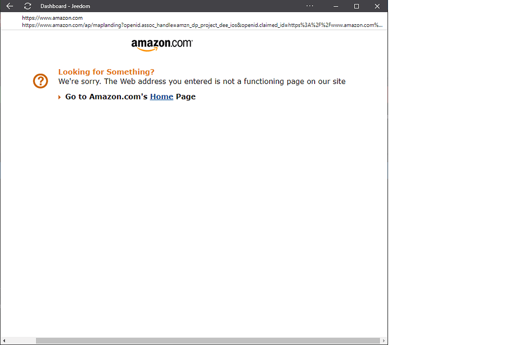

For some time now, Amazon has been making major changes to their identification page and home automation communities have been trying to understand what has changed and what needs to be corrected.
I take care of the Alexa-API module for Jeedom and I’m stuck
I see that Apollon77 is also in trouble.
I tested your version 2.5.7 and it works. Can you put us on the track to correct the problem?
A thousand thanks to all of you.
