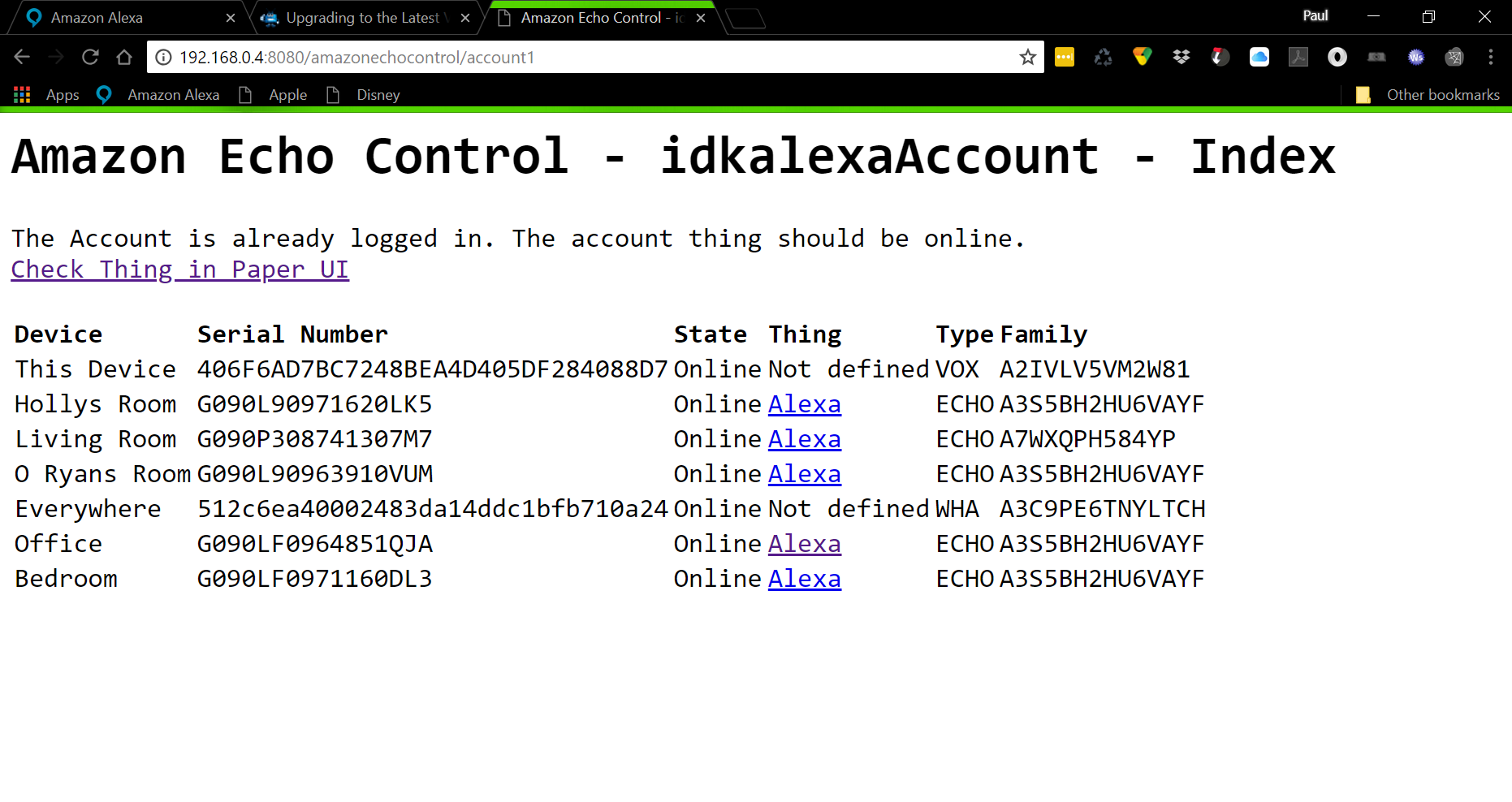

wha device
I canot seem to define the wha thing correctly in the .things file to have it show as defined. See the screenshot.
vox device
Does the binding support the vox device as I cannot seem to get it to show as defined? This is the new device type that the alexa app uses.
.thing file
    Thing echo	LR_Echo		"Alexa" @ "Living Room" 	[serialNumber="G090P308741307M7"]
    Thing echo	HO_Echo		"Alexa" @ "Office" 			[serialNumber="G090LF0964851QJA"]
    Thing echo	BR1_Echo	"Alexa" @ "Bedroom" 		[serialNumber="G090LF0971160DL3"]
    Thing echo	BR2_Echo	"Alexa" @ "Hollys Roomn" 	[serialNumber="G090L90971620LK5"]
    Thing echo	BR3_Echo	"Alexa" @ "O Ryans Room" 	[serialNumber="G090L90963910VUM"]
	Thing vox	Paul_Echo	"Alexa" @ "IOS Device"		[serialNumber="406F6AD7BC7248BEA4D405DF284088D7"]
    Thing wha	ALL_Echo	"Everywhere" @ "Music Groups" [serialNumber="bff62eee1e5f4d838a11447b03cd0131"]
    Thing flashbriefingprofile flashbriefing1 "Flash Briefing Technical" @ "Flash Briefings"
    Thing flashbriefingprofile flashbriefing2 "Flash Briefing Life Style" @ "Flash Briefings"
Paul
