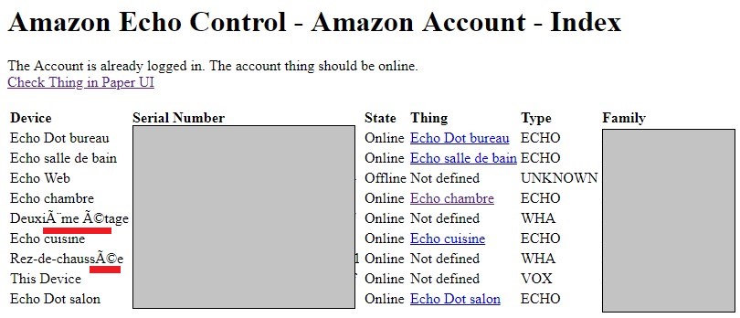

I experience incorrect character encoding with Amazon Echo binding. See how the list of devices is shown (should be Deuxième étage and Rez-de-chaussée).
Any text coming from Amazon has this incorrect character set (name of songs, radios…). Any idea what is causing this issue? I read about UTF8 / ISO8859-1 charset issue…
