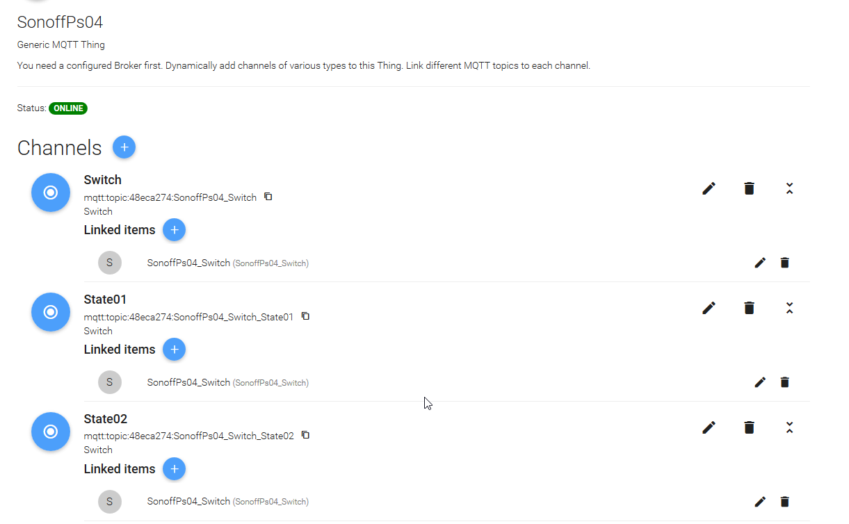

I’ve tried this as well, but I have two problems with this:
  1. The broker connection has issues. I saw the log message, that I should provide a valid hostname/IP. But everything was configured properly and thing state was online. I read somewhere, that someone else had the same issue and the solution was to still use the MQTT binding 1.x, because 2.4 binding is still in development and unstable.
  2. For Sonoff devices I need to consider 4 topics to always be aware of the current item state. The binding does only provide the possibility to configure one topic for state detection (or I didn’t find the correct syntax to configure several topics properly).
So it seems, that using the MQTT 2.4 binding is neither recommended or working for me.

My first attempt is not successful. I was able to get the mqtt2 binding working correctly and I can control the switch via this binding now. But after the 4 channels were created I got 4 switches in PaperUI Control as well, which do not change, if I’m switching the on the device itself. I’ve made something wrong…
Paper UI will show you 4 switches that is correct. Paper UI is a maintenance solution and not perfect in regard to visually displaying controls.
But if you operate one switch all others should be in sync. AutoUpdate behaviour might need to be set to follow if you have manually set it to veto.
All switches have their correct state topic set? Have you tried to turn on the “is command” configuration option? I’m not sure if that is required in this configuration.

OK. I’ve found the issue. The state topic was wrong. Now it works correctly! Many thanks!!
