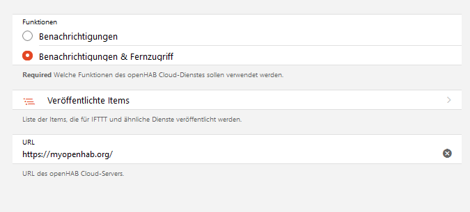

What are your config settings for the openHAB cloud on MainUI?
Did you select Notifications&Remote Access?
yes it is set to:Notifications&Remote Access
i found it :slight_smile:
URL was set to: http://myopenhab.org/
i have changed it to: https://myopenhab.org and now its working
I have set it up that way and do have remote access (note that publishing any item is NOT necessary! )
