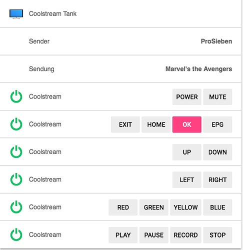

And here the part from my sitemap:
    Text      label="Sender"           item=Sender        icon="none"
    Text      label="Sendung"          item=Sendung       icon="none"
        Switch                             item=Coolstream mappings=[KEY_POWER="POWER",KEY_MUTE="MUTE"]
        Switch                             item=Coolstream mappings=[KEY_EXIT="EXIT",KEY_HOME="HOME",KEY_OK="OK",KEY_EPG="EPG"]
        Switch                             item=Coolstream mappings=[KEY_INFO="INFO",KEY_UP="UP",KEY_DOWN="DOWN"]
        Switch                             item=Coolstream mappings=[KEY_LEFT="LEFT",KEY_RIGHT="RIGHT"]
        Switch                             item=Coolstream mappings=[KEY_RED="RED",KEY_GREEN="GREEN",KEY_YELLOW="YELLOW",KEY_BLUE="BLUE"]
        Switch                             item=Coolstream mappings=[KEY_PLAY="PLAY",KEY_PAUSE="PAUSE",KEY_RECORD="RECORD",KEY_STOP="STOP"]
I looks in the sitemap like that:
55
Have fun with it.
BR Peter
