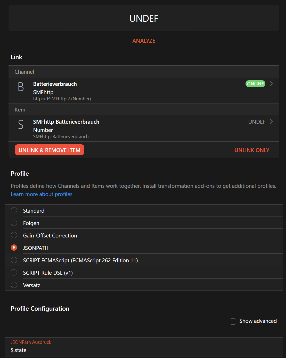

The item definition is like that:
And the error in the log is this one:
[ofiles.JSonPathTransformationProfile] - Could not transform state ‘UNDEF’ with function ‘$.state’ and format ‘%s’
OMG…
The error should be self explanatory. In your screen shot the Item’s state is UNDEF. UNDEF isn’t JSON. You cannot extract any value from it.
The HTTP binding will set the Item’s state to UNDEF if the HTTP call fails for some reason.
