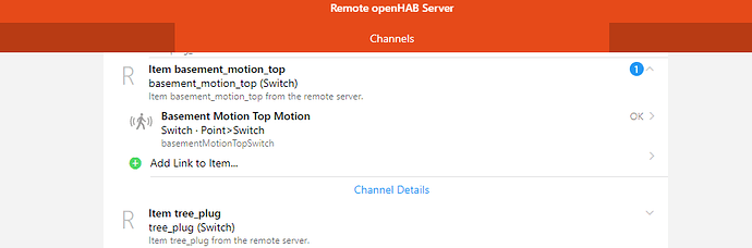

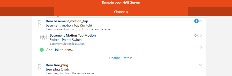

I believe the server is more useful than the thing. When I tried using the thing and opened a GitHub Issue I was told I misunderstood the purpose of the thing in remoteopenhab.
EDIT I just looked at the documentation and we need @Lolodomo to help clarify, I think.
That issue needs to be fixed first then. I think it takes a few minutes for the binding to discover the server channels once online.
