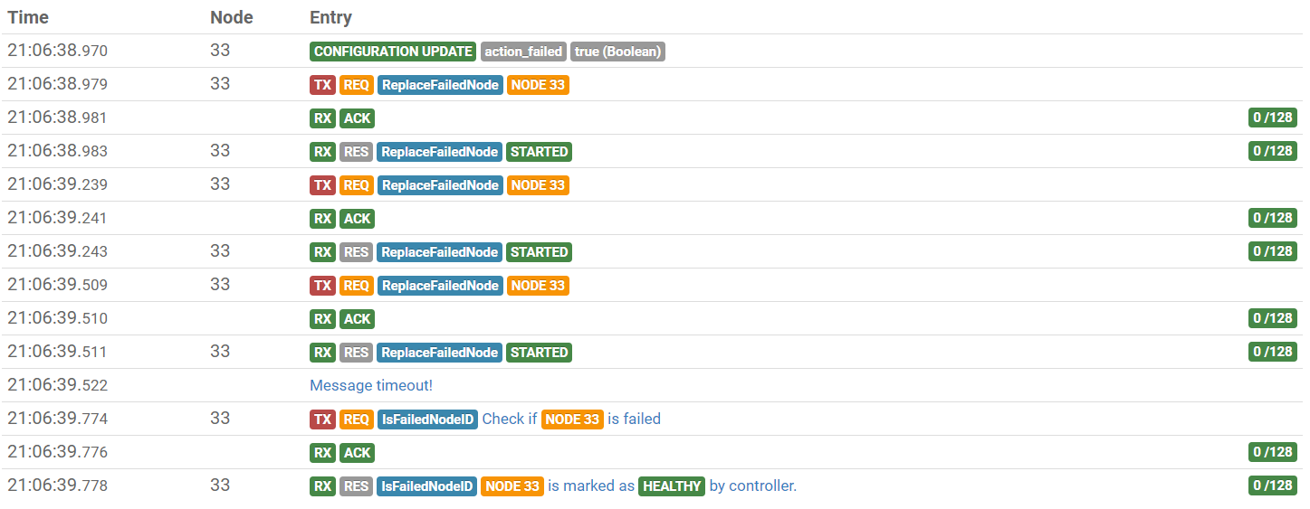

sorry but I can’t find a way to remove a dead node from my controller. There is no real problem now, but it would be nice if I can remove the node.
I tried to set the node as failed in HABmin. This is the debug log:
But the device is now NODE 34, not 33. Why the log tells me my node are healthy?

I think @chris said if you mark the Thing as failed in HABmin the controller may remove it.
Of course, you then need to delete it from HABmin after some time.
You can’t remove nodes that are working - the controller will not let you. If the node is working, then you should simply exclude it from the network.
If the node is not working, then you need to mark it failed - the controller will only allow you to do this if the controller thinks it really has failed. Once it is in the controllers failed node list, then you can send the command to remove the device.

So I tried exacty what chris said, I tried to set the device failed in HABmin.
What can be the reason that the controller think the device is working? It isn’t.

Didn’t we determine that the Zensys procedure includes sending a NOP as the first step? If the node isn’t in the controller’s failed list, won’t this step makes sure the controller has the node in the failed list? That’s the only thing I saw that’s different between the Zensys procedure and HABmin.
You might be right - I don’t recall.
I don’t know - I’ve not looked at the controller source code. In theory, I expect that the first command sent should do that - that’s what it is for (ie the command to set the device into the failed list should, well, set the device into the controllers failed list). This command should explicitly do that according to the documentation, but it might be that it doesn’t always work and the NOP is required.
Do you have the reference for the discussion we had on this?
It’s further up in this thread.
Thanks. So I see that I (rightly or wrongly!) concluded the same thing at the time - that the NOP is just there to get it into the failed list, which should do the same thing as the “set node into the failed list” command.
In the log you provided above, you don’t seem to use the “set node as failed” command at all.
I can try adding the NOP before the “set node as failed” command to see if that works, but it’s a bit messy. Something else that you could try that does the same thing is to send any command to the device.
