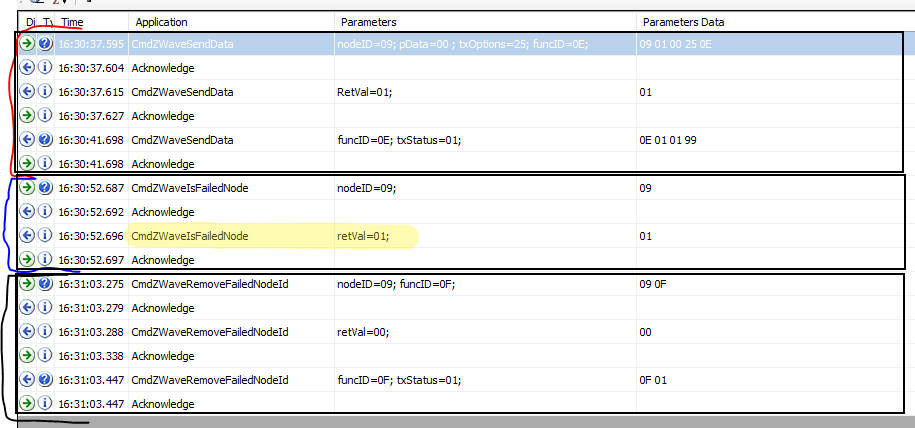

@chris I haven’t had as much time as I thought… Spent a little too much time figuring out how to use Wireshark to capture a USB trace. :frowning:
But, I now have a trace of the conversation between the Zensys tool and the ZWave stick when performing the following steps in the Zensys tool.
  • Send NOP
  • Send IsFailed
  • Send RemoveFailed
I’ve marked and annotated the packets as best I could. Are you familiar with Wireshark, and, if so, could you take a look at the pcap? If not familiar with Wireshark, I might need you to help me out with the analysis.

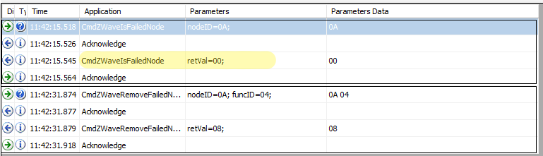

@chris I ran the test using the Zensys tool without first sending the NOP. The ghost node was not removed. Without doing too much further analysis, I think I can conclude that the NOP is an important part of the process. Perhaps that’s why the removal often doesn’t work using HABmin. WDYT?
And, you can see in the packet list from Zensys that isFailed results in a different response from the controller. I have the full USB traces for both test scenarios, in case we need to look at all the details of what is sent/received.
With NOP

Without NOP
zensys-remove-n9-without-nop

I’ll post the actual bytes from the trace for IsFailed and RemoveFailed. I’ll need your help to extract the actual zwave frame because there’s some USB protocol stuff in there, too.
IsFailed
IsFailed
RemoveFailed
RemoveFailed
The operations are being performed on node 9.
IsFailed is 0x62, and RemoveFailed is 0x61, right?
So, if I’m reading this right, the Zensys tool is sending what you call IsFailedNodeID (0x62) followed by RemoveFailedNodeID (0x61). However, in the case of the Zensys tool, those commands must be preceded with some other command (such as NOP or BASIC SET); otherwise, the removal won’t work.
