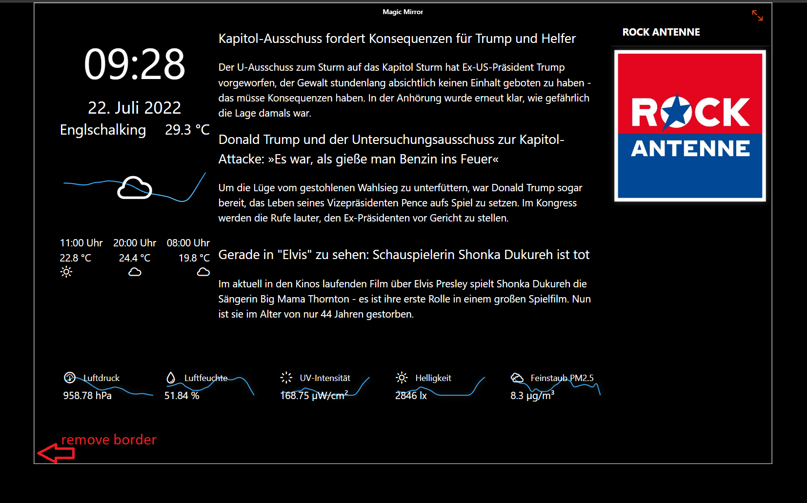

I use a fixed canvas page to fill a “magic mirror”. Unfortunately, a white border is created around the page. Is there a way to remove this?

but it also removes the album cover in the top right (Rock Antenne). Is there a way to remove only the white borders?

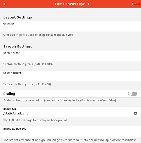

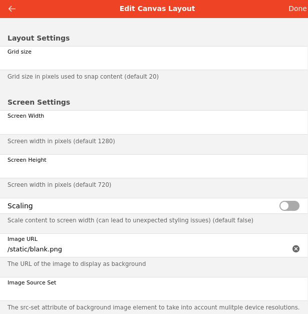

This is not how you set the background within the canvas page. If you read closely up above, the canvas actually creates an <img> element to show the image which is defined using the imageUrl property. This is not the same as setting the background of the canvas element itself with css. So, your code still shows the border because the <img> element is still there’ it’s just blank.
Thank you.
imageUrl: ="/static/transparent_144_144.png"
Thank you! This solved my problem too! :slight_smile: Maybe we can fix it so when imageurl is not defined, that image element isn’t rendered at all!
This could just be
imageUrl: /static/transparent_144_144.png
In my case, I used https://upload.wikimedia.org/wikipedia/commons/c/ca/1x1.png
