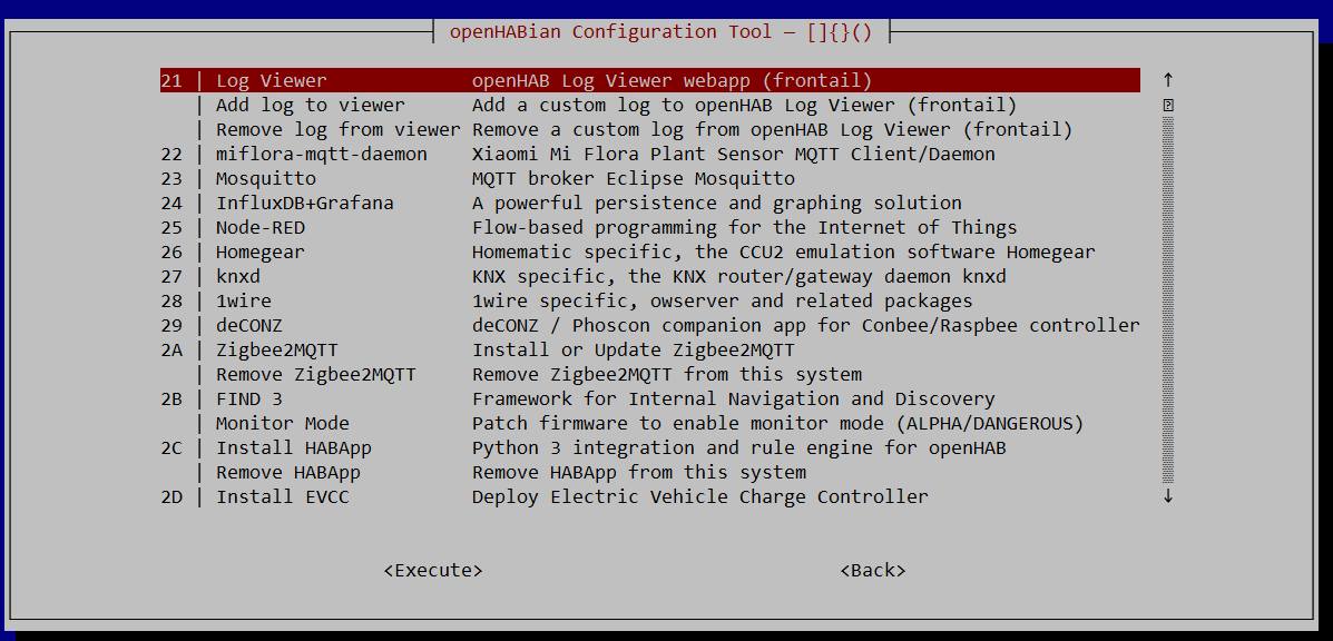

Hi, please see below from OH 4 M1
Menu 21
Remove log from viewer:
No menu to remive frontail completely.

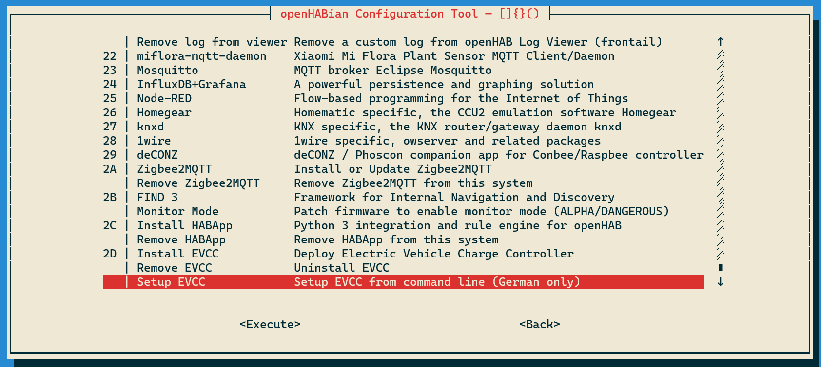

If you scroll down? The scroll bar on the right indicates there are more entries in the list.
If it’s not there it might be under menu option 30.
In a pinch from the command line you can run sudo apt purge frontail, however, I’m not sure that removes it from the list of other UIs from MainUI. It would be better to remove it through openhabian-config.
Unfortunately not. Also menu 30 does not have any related entry to remove frontail.

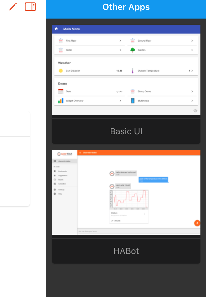

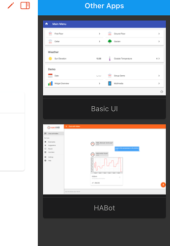

Doesn’t is show up here?
I don’t think anyone is asking you to implement this. But if a PR were provided, would you reject it?
Oh, right. Haven’t used that in a while.
