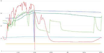

My heating system can be accessed via a RS232 serial connection and has a known bug, which spits out some unrealistic item values like this:

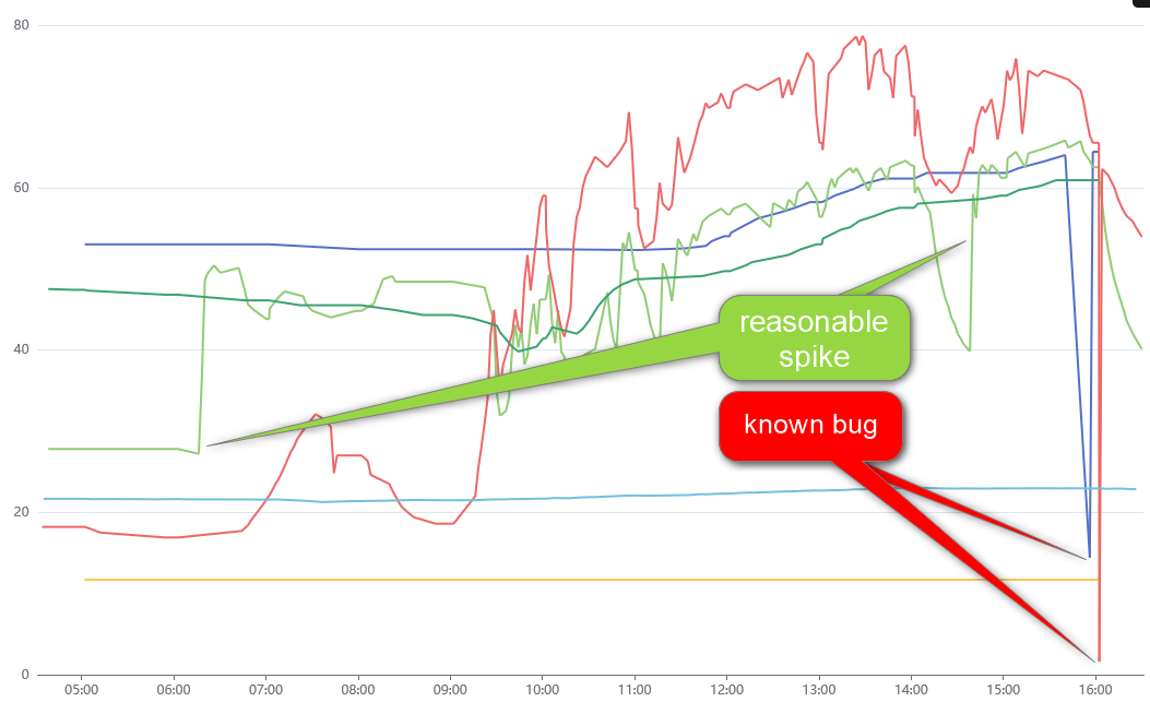

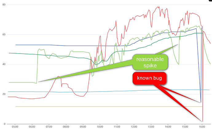

Yeah, I wrote that script… and about that! :wink: I kinda tried this and sometimes the delta could be within plausible reach. So, for example the readout interval is at 2minutes and for some reason one of my three heating possibilities start (solar thermic, wood furnace or gas heater), within two minutes there could be a certain spike in temperature → see here:
And if I ignore the first “spike” from 39.8°C to 51.9°C (that’s within 2mins), all the readings afterwards get discarded, too. Because my script still thinks 39.8 is the baseline…

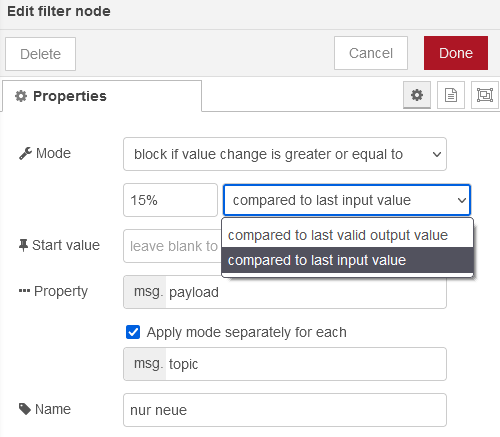

Ok, so as I use Node-Red anyways for all different kinds of stuff, I connected my read-outs with Node-Red.
Within Node-Red, there’s an ootb-check you can use to block some values depending on their predecessors. It’s called “RBE-filter” (Report by Exception).
With 2.something version of node-Red, there was some improvements on this node, so you can now choose from “last input value” or “last valid output value”. So if I’m to combine rlkoshak’s approach with Node-Red, I now have implemented this one:

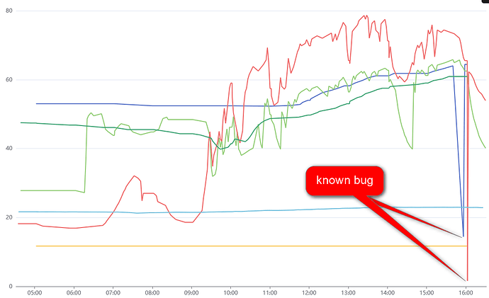

So with that I get basically Rich’s approach without messing with openHAB rules and logic. Usually the bug appears at least once within a few hours, but since I implemented this, I got some real smooth graphs:
So, I guess, this works now! :wink: Thanks for your help!
