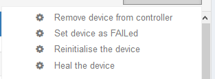

With the OH 2.4 z-wave binding you can do this with HABMIN. On the right side select advanced settings. Her you can find “set device as FAILed” and “remove node from controller”. For me this is now working.
Use it the the mentioned sequence and wait 1min. for the second one. I think the controller must do a little work. After that the nodes are deleted from controller and should not come back. Sometimes they do, then just delete xml file and do it again.
