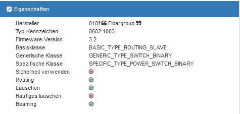

Here are the properties of the wallplug:
Does anyone has an idea what is wrong?
