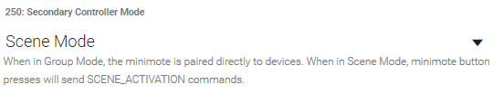

I’ve got a aeotec minimote set to operate in scene mode. Pressing the first button activates scene one, holding it activates scene two. Repeat across three more buttons giving you control of up to eight scenes on the remote.

1- Configure the remote for scene mode.
This sets the remote to send scene commands to the wider zwave network, instead of talking directly to the devices on the network.
