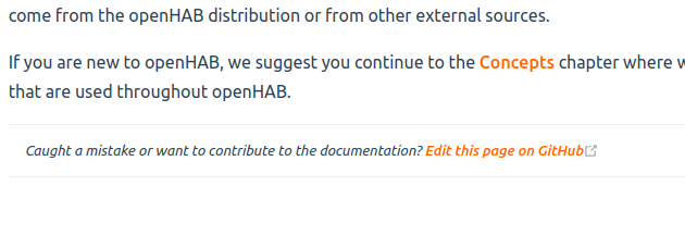

At the bottom of each page in the documentation, there is a link to the github page where you can suggest edits. It looks like this
