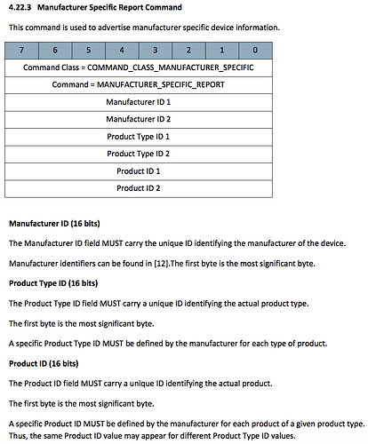

See below -:
This states that the manufacturer ID MUST carry the unique ID for the manufacturer - clearly, FFFF is not the correct ID for TKB.
