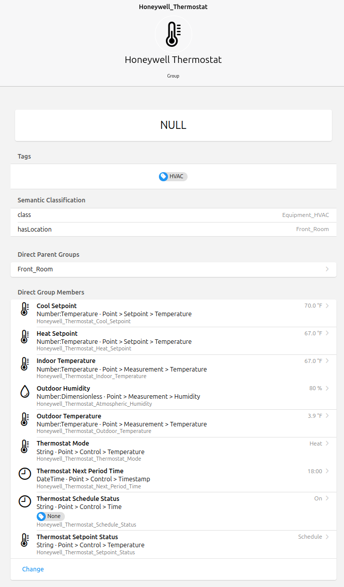

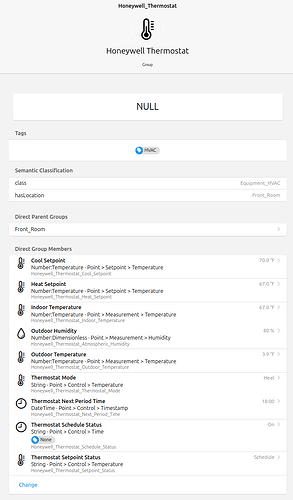

All channels appear to be reporting.

All seems well here for the day it’s been running. I’ve not tried to exercise it much yet by changing anything but so far the sensors are reporting correctly.
More to follow if something crops up but if you don’t hear from me it’s working and meeting my needs.
