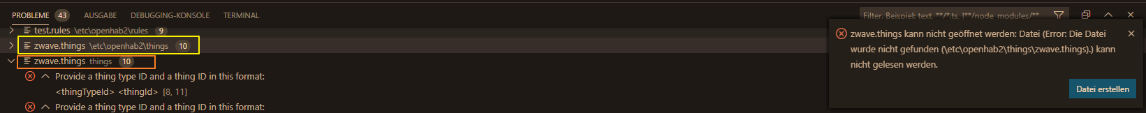

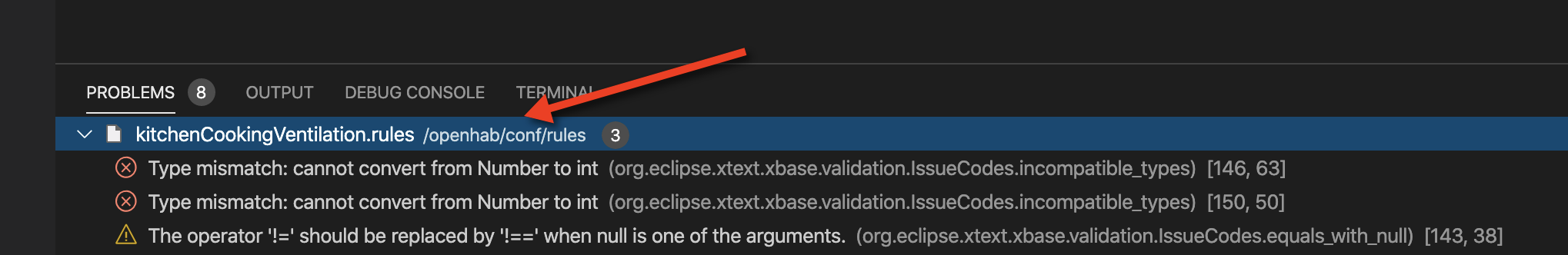

I now have a problem with the file paths referenced in the PROBLEMS tab. They all are referencing the rules files by an absolute path /open/conf/rules.

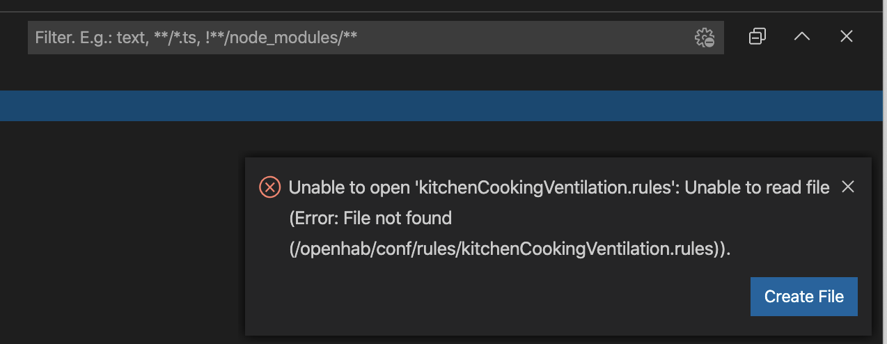

And clicking on the problem the file cannot be opened:

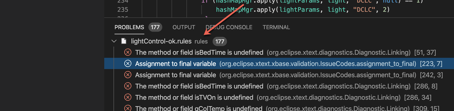

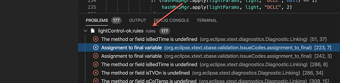

I started on a test server docker container 2.4.0, just to be sure that the new version of VSC did not introduce the issue:
on 2.4.0 there is not path to the file containing the error
For some unknown reason the issue disappeared
I’m having the same issue after upgrading from oH 2.4 to 2.5 on Raspi 3B running openhabian.
AND some files are shown with absolute and relative paths:

I had the same issue while I had not saved a VSCode Workspace yet. Since I have done so, the issue has disappeared. I had to restart VSCode though to get rid of some old problems pointing to the wrong path that would not dissapear even when resolved. After that, all seems fine.
