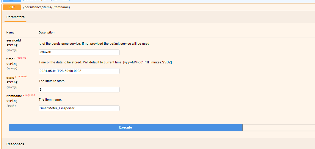

and got that the time is not a valid format
Is the time not correct ?
hm, what´s wrong
I din’t think the T part needs quotes.

curl -X PUT “http://192.168.158.170:8080/rest/persistence/items/SmartMeter_Einspeiser?serviceId=influxdb&time=2024-05-24T12:59:00.000Z&state=8.125” -H “accept: /” -H "Authorization: Bearer curl -X PUT “http://192.168.158.170:8080/rest/persistence/items/SmartMeter_Einspeiser?serviceId=influxdb&time=JJJJ-MM-DDTHH:MM:SS.000Z&state=8.125” -H “accept: /” -H “Authorization: Bearer eyJraWQiOm51bGwsImFsZyI6IlJTMjU2In0.eyJpc3MiOiJvcGVuaGFiIiwiYXVkIjoi… -v”
I got this command with the api explorer, but where does this authorization chain come from?

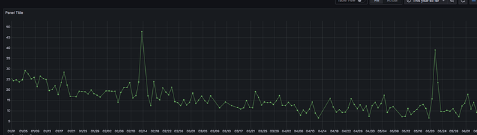

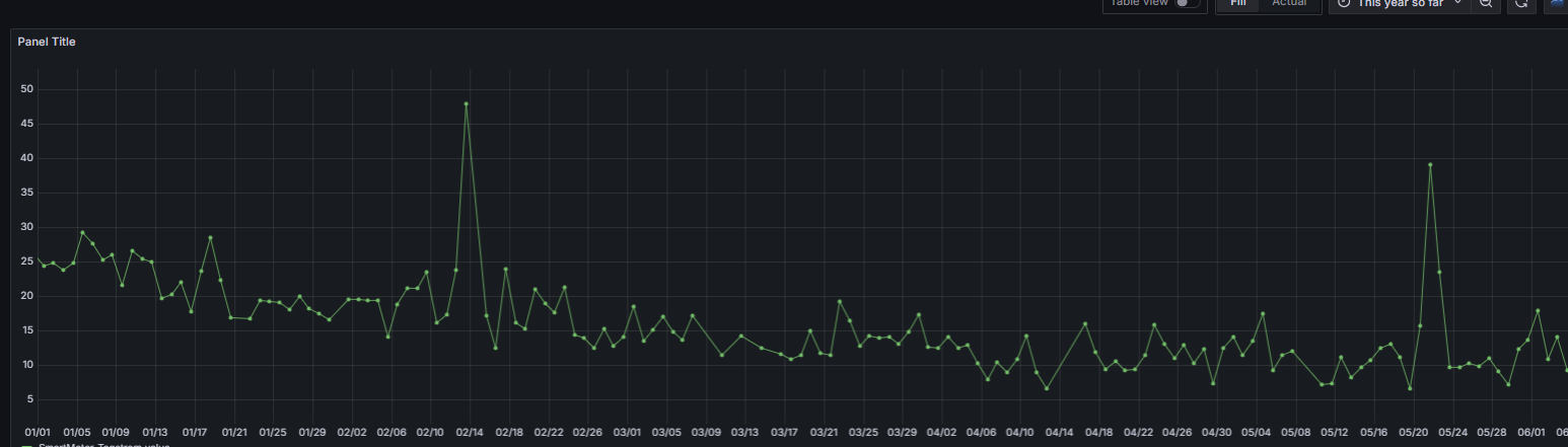

All likes good in grafana
