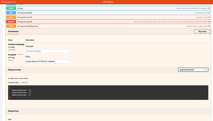

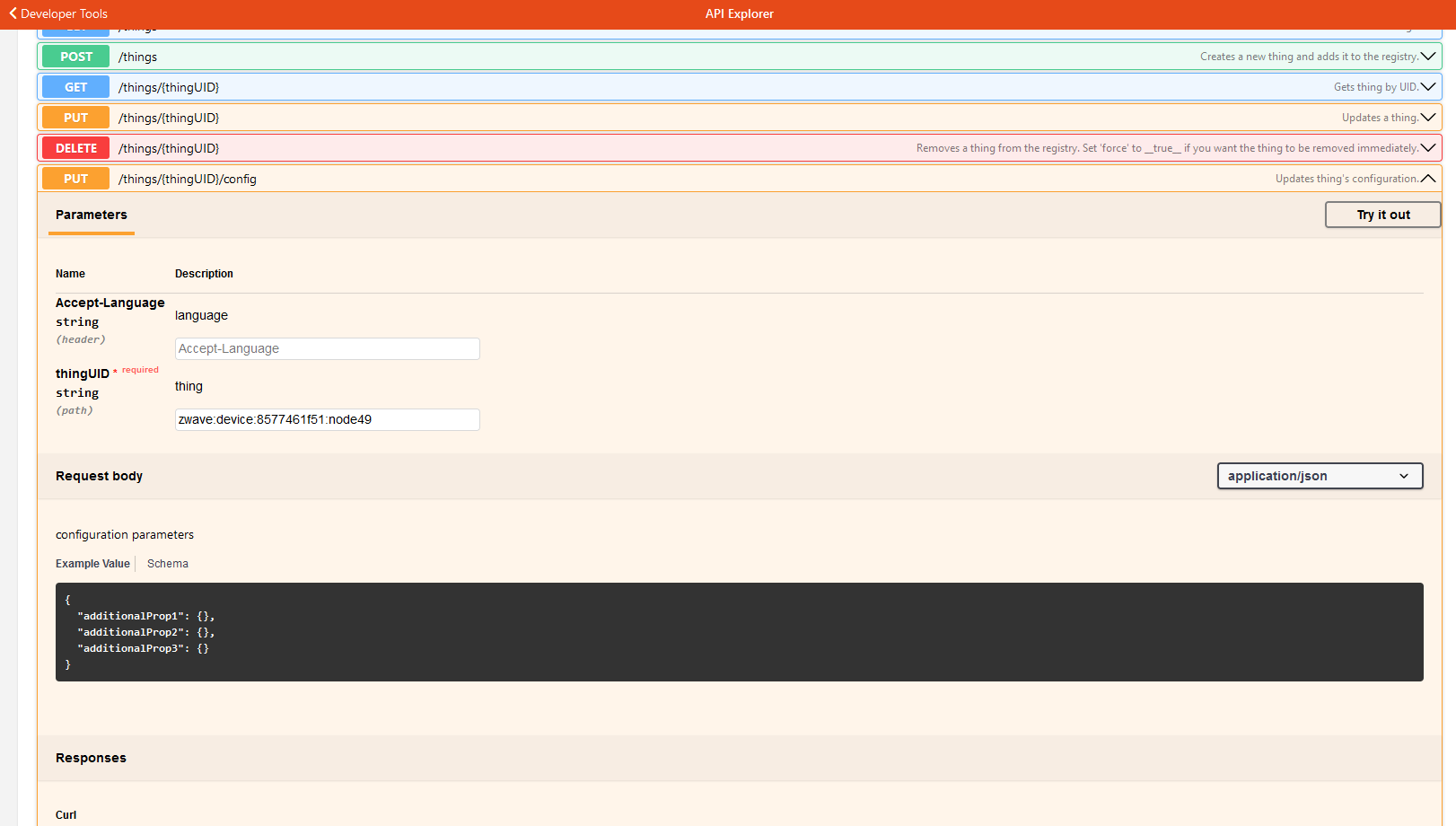

This is what the RESP API screen looks like
I have tried all the permutations I can think of to change
usercode_code_6 to 12345 and I always get a server error response code 500
For example when using
“usercode_code_6”: 12345
I get
When typing
{“configuration”:{
“usercode_code_6”: 12345}
I get
  "error": {
    "message": "Invalid type '{com.google.gson.internal.LinkedTreeMap}' of configuration value!",
    "http-code": 500
Can anyone tell me how I have to format the request body to change the user code?
Thank you
