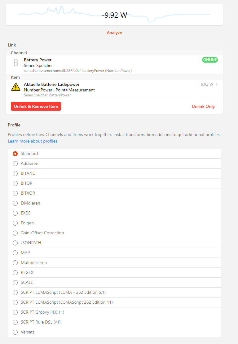

Hi everyone and happy new year. sorry for late response. so where can i find the profiles in the gui? so that i have a timestamp for an item? the rest api trigger i can build that will not be a problem but finding the profiles is hard for me at the moment or i am blind :wink:
probably :wink:
Whenever you create an item from a channel you can select a profile. Usually the default “Standard” is kept but you can select the timestamp too.
You can change the profile afterwards too (things - select it - channels - select item - scroll down)

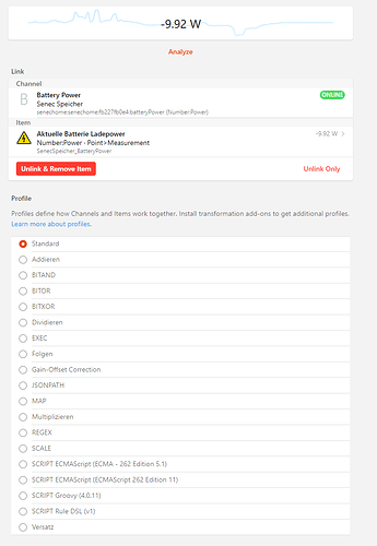

Did you mean that here?
Yes, he means this profiles.
Go to the channel, link new item, create a datetime item, then you can select time profile last change (zeitstempel bei Änderung)
