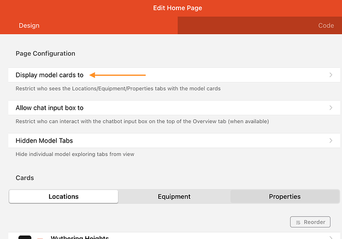

You can change the security settings to that they have to log in in order to see anything at all. In MainUI navigate to Settings → API Security and turn off “Implicit User Role”. That will force everything in OH to be closed except to authenticated users.
You can omit Items end users should not interact with from the semantic model. Those won’t be shown in the autogenerated tabs.
You can hide the auto generated tabs from all users in the overview page settings. This is different from visibility in that it doesn’t even render those pages any more.

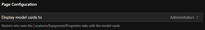

You can restrict who sees those tabs with this property:

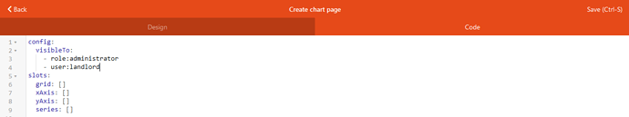

That being said with visibleTo to you can:
  1. restrict the display to additional roles (role:apartment1) (that you define in the Karaf console)
  2. restrict the display to specific users (user:landlord)
I know RBAC systems have been implemented in forks but they aren’t part of openHAB because they haven’t been suggested for inclusion to the upstream yet.
oh wow. I did not know this. Because in the UI you can only choose the role, but not the specific user. This is great. Thank you.

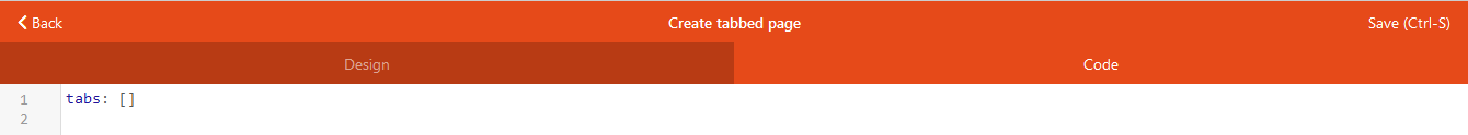

I can not edit the parameter because it is not shown on the ‘Code tab’. Also I can not create it manually. When I save the page it is disappearing. I am missing:
  visibleTo:
At the moment I am running openHAB 3.3.0.M3.
I think it’s all or nothing.

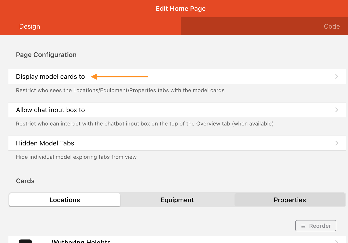

You can hid all the model tabs or show all of them based on user.
Or you can hide certain tabs from all users with that “Hidden Model Tabs” option.

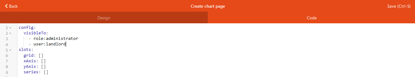

Also you can do for “normal” pages. E.g. chart page:
grafik
Now I have one problem: Why is this not possible fĂŒr tabbed pages? The configuration is missing in the codes tab:

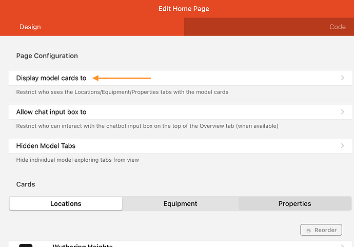

@ysc Do you have an explanation for this?
grafik
There is already an issue filed on github:
https://github.com/openhab/openhab-webui/issues/1276
